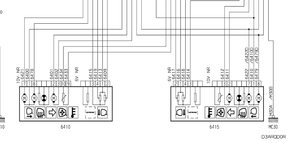

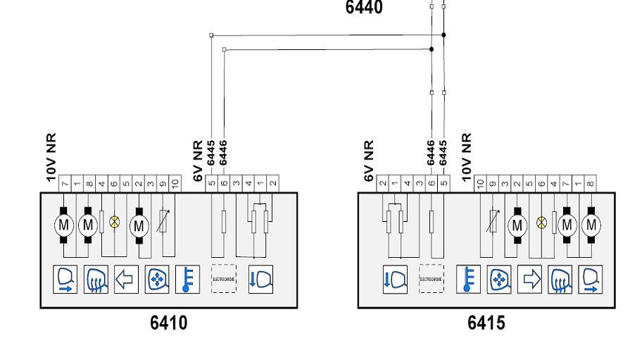

So it would seem you have bought a mirror with even less functionality (see my last diagram in the table).
There are at least 7 types of passenger mirror depending on your build, so I would need your VIN. Then I can get you the part number for the replacement identical to yours and you can at least search on the right within the second hand market.

| Driver / Passenger Mirrors (6410 &6415) Above 6445 and 6446 are for the Electrochrome supply and Earth function only. These 2 wires go into the 6 pin Black Connector (6V NR) |
| Mirror Electrical Function passenger Mirror (6415): the other 4 wires going into the 6 Pin Black plug along with the electrochrome in first diagram are positional commands left right up/down. The Foldback Functions are handled in the other 10 Pin Black connector (wires 6422, 6410 & 6479). |
| Your Second Hand Mirror As you can see, it is likely you have bought the wrong mirror. This one has only the Up/Down Left/Right and Fold back option and has one 10 Pin Black connector (10V NR) The Electrochrome wiring is missing - which would go into the Black 6 Pin as in the first Diagram and would be on a second cable. |
