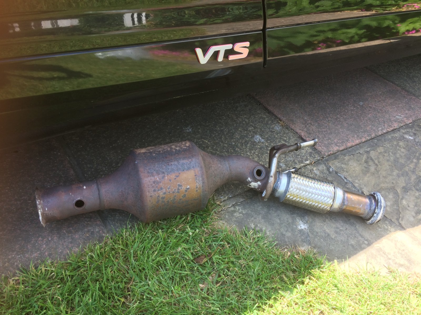

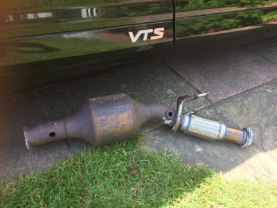

Just had a strange one yesterday, exhaust started blowing a bit, then more and more whilst my son was learning basic clutch control on the drive. Had a look underneath this morning and the exhaust has broken off where it clamps to the manifold. It looks like a 'flexi'. The rest of the system looks brand new! Is there such thing as a repair section? I could do without putting a complete new cat on.
One other thing, do the two sensors either side of the cat just unscrew?

There are a few on here. The one on my wifes 206 rusted through at the other end, tried to weld it but had to get a new cat eventually.

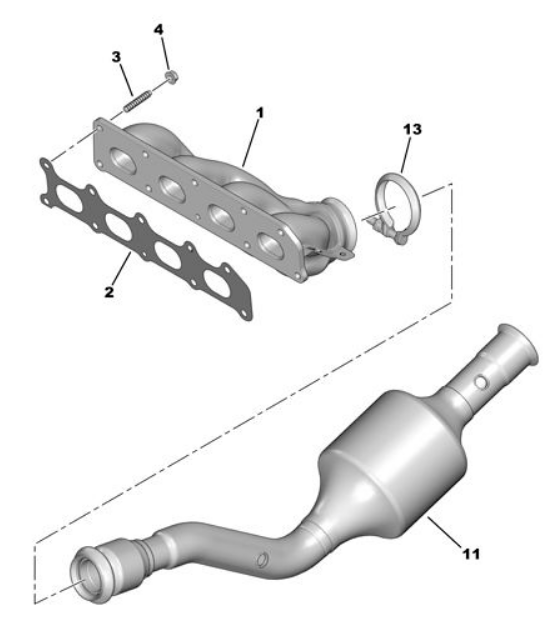

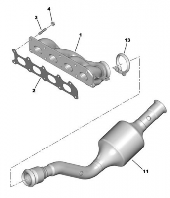

| (13) is the fixing Clamp (Diameter 74.5), Part 171369 (Price £7.82 inc VAT from dealer) (11) is part 1731GY or Replacement Part 9805707980. |

Cheers for the info. I found this https://www.24piecesauto.fr/7703126-ebe ... chappement and this https://www.ebay.co.uk/itm/BM-Premium-E ... 23a1bf81fd
I'm going to have a go at welding the lip back on, nothing to lose apart from a bit of wire and gas. If it doesn't work I'll go for the complete system at that price.

The cat on mine has had a new flexi welded on
