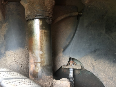

‘Failed’ suspension strut...
- x 6945
Re: 2001 C5 front suspension leak
That’s not a fail in my book! He’s got that wrong if there are no drips leaks or puddles of accumulated fluid. Misreading the guide!
That looks fine to me...
