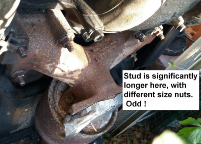

It was immediately obvious that its the Resonator, which is quite spectacularly knackered as you can see. Oh well, I thinks, got one of them, no problem, but I’ll get the threads wire brushed, get some PlusGas on em coz they’ve obviously not been touched in some years so I’ve got a better chance of trouble-free undoing when the new Gaskets arrive.... maybe stick a spanner on ‘em, see how keen or not they are to move.
That’s where it all went wrong!
Off I went underneath the motor armed with Drill, Rotary Wire Brushes, and increasing amounts of tooling (at least I was in the shade!) that a 13mm is a mile too big, as is a ½ inch, I’ve not quite got room to force a 7/16 AF onto ‘em and none of my WW sockets will fit. A 12mm metric slips round and an 11mm metric is way too small.
Bizarrely (this doesn’t make sense at all), the nuts measure 12.3mm on the Digital mic'

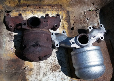

wahey, its off, and it wasn't the palaver I expected. Undid the Hub Nut as a precaution, but no need to have the engine off its mount or remove the PAS Pump, Alternator or Driveshaft.
13mm socket fitted nuts one side which were in fair nick. Forced an 11mm onto two the other side and cut the third. They had the look of having been mullah'd last time they were moved, but refitted nonetheless.
Good nick s/h replacement has been treated to a couple of coats of VHT to help combat future tin-worm. Black would've looked better, but the rear box is only a couple of months old and will get a coat too, hence silver. I toyed with the idea of blanking off the resonator, but no point, having one readily available.
