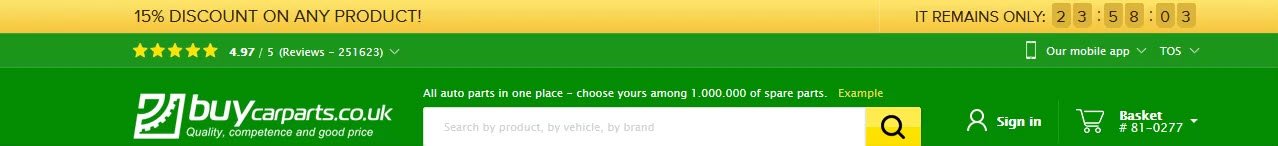

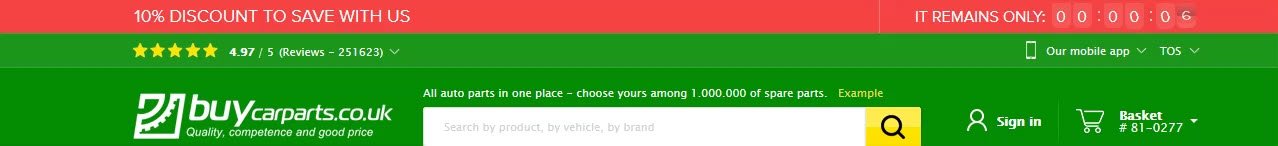

Pete - Tip
Be careful with buying stuff from these, they have a few websites/online company names and the discount varies daily.
I bought some brakes discs from another one of then sites, good price, good parts, but a few weeks later when I checked I could have got them cheaper!
I started writing this message with 10% discount 5 minutes remaining,so I waited and when I refreshed the screen it went to 15% discount!!
Stu
- x 2941

Must be getting old and slow. So many different specs. It reminds me of when my dad asked me to program the video player back in the 80's! Found the spec, any advise on brand? Taking mileage into consideration, I'm assuming that regular changes are more important than brand as any damage done has been.
Stu, the price with 15% off is more expensive than the price with 10%!

Re: am6 oil
moizeau wrote: 08 Jul 2018, 13:30 .............Stu, the price with 15% off is more expensive than the price with 10%!
Pete
As I said Pete "..........Be careful with buying stuff from these......"
Gibbo2286 wrote: 08 Jul 2018, 09:18 Percentage discounts mean nothing Stu, 10% off what? the only price that matters is the one on the final invoice.![]()
I agree that the important thing is the final price, in most cases, but how they get there is worth noting as well.
Stu

Re: am6 oil
Sloppysod wrote: 08 Jul 2018, 14:55moizeau wrote: 08 Jul 2018, 13:30 .............Stu, the price with 15% off is more expensive than the price with 10%!
Pete
As I said Pete "..........Be careful with buying stuff from these......"Gibbo2286 wrote: 08 Jul 2018, 09:18 Percentage discounts mean nothing Stu, 10% off what? the only price that matters is the one on the final invoice.![]()
It's quite simple really, the seller decides what he needs to make a profit, adds fifty percent for the asking price, the RRP, then offers it with a ten percent discount off the RRP, he takes a few suckers at that price then as it all slows down offers it at fifteen percent off the RRP......then twenty and he's still quids in.
