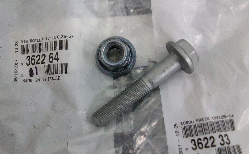

Here's the bolt in question
Bit inconclusive! The bolt is listed as 57mm, so it looks like about 20mm of shank. It could be threaded into the hub... but they're not normally. I'd get the hub off the van so that you can get a proper look at it!

OK. I got it off eventually, by dremelling away some of that shoulder so as to get a decent 'bite' on the bolt head, then applying a nice long breaker bar. It is indeed not threaded into the clamp (I didn't expect it to be, but it resisted coming out quite hard and I was beginning to wonder). As ever, getting the balljoint stub out of the clamp was a bit of a pain too. Still it's off. Now I realise that just about everything in this area needs repainting so I'll do a load of that before putting the new one back. I'd better buy a new bolt too.
