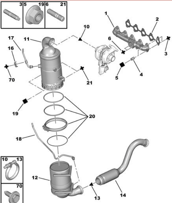

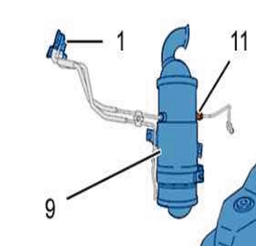

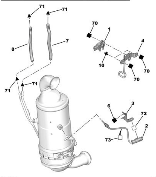

Ok, so here in the first picture are the diff pressure mechanical pipes 17 (inlet) & 18 (outlet). On the second diagram are the flexible pipes that connect to these (8) & (7); and on the third diagram Item (1) is the actual pressure differential sensor that the pipes connect to. This is designed to be a safety system to prevent regeneration if the filter is blocked.
If there is any available data from this sensor, then it will likely be accessed from within the Engine ECU itself. So go into there and have a hunt about for the readings.
