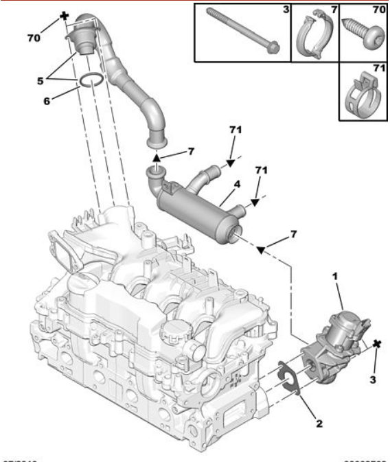

What are the symptoms of this on the 1.6 hdi? Think I may have this, which side is it located on the Dispatch?

Here you go Rich, number 1 in the diagram, so round the back at the bottom right!

Ps Marc, that diagram is different to my van, is that for Berlingo? Dispatch is on side of engine under cabin filter housing

Dispatch Rich - I was going off an old VIN - (ending in 013) - have I been using an older Van?

Not sure mate but mine is located right side of rocker cover just under the cabin filter, it’s a totally different shape to the one you posted, but I found it now anyway thanks. What do you think to my earlier question re air intake?
