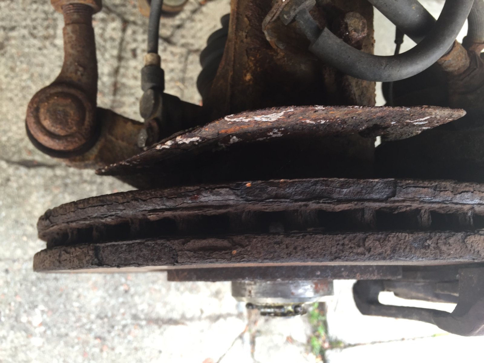

I've done very little mileage on the Xantia in the last year (maybe 2k at most) and MOT time is coming, due mid July. Last time I was warned that the front pads were down to minimum thickness, so leaving it rather late I had a chance to look at them today and didn't like what I found.
The pads are indeed down to about 3mm of lining left, and are totally wedged in the pad carrier - I was unable to remove them to try to free them up without actually damaging and de-laminating what was left of the pad material, so I decided not to try any further. So it absolutely definitely needs new pads and the old pads will need to be butchered to get them out.

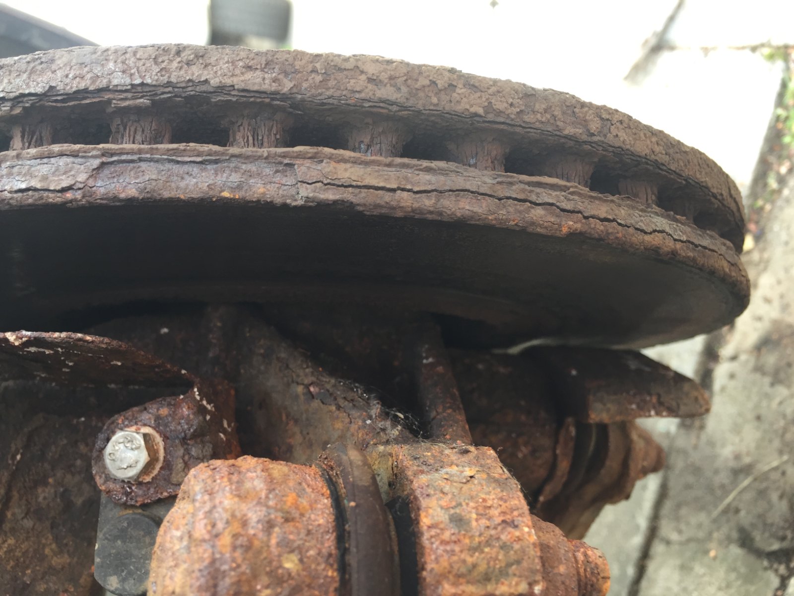

Before starting I thought I might get away with keeping the same discs but after having a look today I think they're well past saving. They have sufficient thickness left but they're literally exploding with rust with a bit split "seam" around large parts of the circumference.
Also they have had a problem with vibration when braking hard from high speed for a couple of years, which gets worse as the discs heat up - I knew the discs were probably to blame but had been putting off replacing them. On the inner surface of the disc towards the middle of the disc there is a very old "rippling/bubbling" effect to the surface where it is not flat but kind of lumpy, a bit like bubbles in wallpaper - I can only assume that there is so much rust inside the disc that it is causing bubbling of the surface! #-o
Anyway, I'm looking for advice on what to get because I've seen a few posts on her saying 3rd party discs/pads for the Xantia V6 leave something to be desired, so what should I get ?

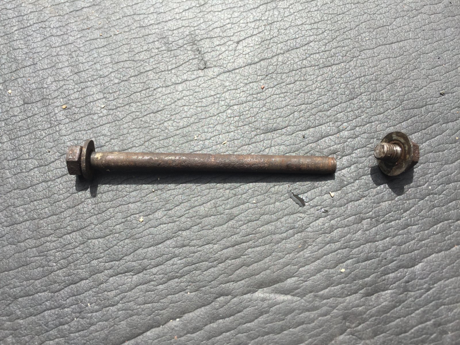

While stripping the rear brakes to give them a clean and check, (as they also haven't been working well recently) I managed to break the main pin that goes through the eyes in the pads. Must have been pretty rotten as I was using the tiniest spanner and ratchet in my toolbox - both are only about 4" long so it's not like I was applying a lot of force! :roll:
Service box shows the bolt, washer and nut with captive washer as 3 separate part numbers, if I order one for both sides of the car (as I'm now worried about that breaking too) it's £7.66, which is not the end of the world, but I have a strong suspicion that there will be a considerably higher minimum order than two of each bit! #-o
I don't suppose anyone has a couple of these lying around ? Has anyone else ever broken one ? First time it's happened to me after years of working on many different Xantia's, so it never even crossed my mind that it might happen! I was planning to overhaul the rear brakes today since I can't do any more on the front but that is now stopped dead until I can get replacement bolt(s). [-X

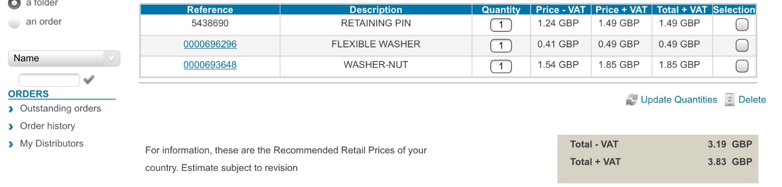

Those pad retaining pins are only £1.49 inclusive each and nothing to say they are not available individually, which usually is for trim clips and plastics that sometimes come in a pack.

£1.49 ? Did you include the washer and nut with captive washer in your price ? The reason it broke in the first place is because the nut was badly rusted.

Simon, that bolt doesn't do a lot other than hold the anti rattle springs in place you could bodge it with a bit from a wire coat hanger until the new bolts arrive. :)

Just the pin, but here are all three with part numbers and prices (Mark I 3.0 V6)

myglaren wrote: 23 Jun 2018, 13:43 They are allegedly available from Halfords - who order them in from ECP.
Yes, I have had the same experience :(
You sir are a champ! :)
I assumed it would be dealer only but you spurred me on to search ECP and while it was difficult to find I did find a kit which includes the springs, nuts and bolts and even the stone shield:
https://www.eurocarparts.com/ecp/c/Citr ... 56a&000416
As I'm going to order front discs/pads from Mr Auto I checked and sure enough they also have a rear brake accessories kit:
http://www.mister-auto.co.uk/en/accesso ... BA460.html
So £6.80 gets you a full kit for both sides, and I'll just order this together with the discs and pads. Problem solved! =D>
