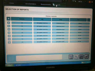

When I close Diagbox I don't get the question "Do you want to save a report?" I used to but lately I haven't. I have looked and can't see how to do this.
All the saved reports are from sessions several Months ago
How to save report in Diagbox

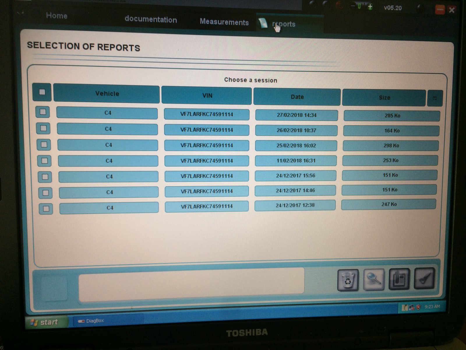

Those listed in the screen shot are 'Sessions'. Each 'Session' can store multiple reports.
A Navigation Report is created when the vehicle is identified and ends at the end of the session (when a new vehicle is selected or DiagBox is closed. All operations performed during a session are recorded.
Pressing the search (magnifying glass) at the bottom right of the screen, allows you to search on:

Thanks for replies so far!
I have tried searching with the magnifying glass already and no more reports seem to exist.
Both today and yester day I completed more sessions and tried closing Diagbox both with the red x in top right corner and also with the "quit" in the drop down on the left. Still it wont save the session. What else can I try?
GiveMeABreak wrote: 23 Jun 2018, 15:17 Those listed in the screen shot are 'Sessions'. Each 'Session' can store multiple reports.
Pressing the search (magnifying glass) at the bottom right of the screen, allows you to search on:If there are no more reports, it may be because the session was ended without closing Diagbox down properly. I can't see that there is a limit anywhere as these are ultimately stored on your laptop,
