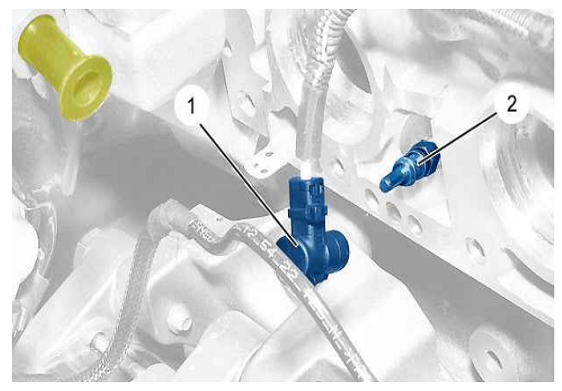

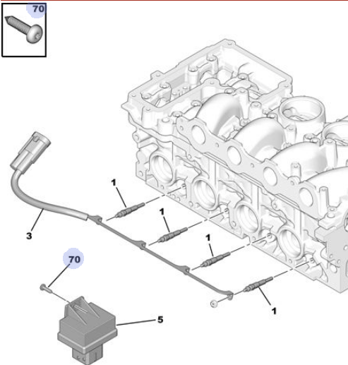

Unless you really need to do this I would leave them. They are very prone to breaking up and snapping if seized and a torque of 1,7 daNm will snap them if they are seized.
They do very little on the HDi to be honest and are best left unless essential given the hassle of replacing them and the copper seals etc
The air inlet manifold has to be removed first.

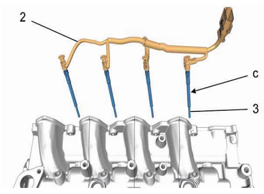

Thanks for the reply most helpfull. So can I confirm they are at the front of the engine under the air Intake manifold. Think they might need replacing as was hard to start in the winters cold weather. If prone to snapping I might leave the job to a garage and let them deal with it.
x 6957
Re: Glow plug location
For the 2.2 175, yes from the looks of it and also, on refitting, the plugs need to be tightened to 0,85 ± 0,1 daN.m.
