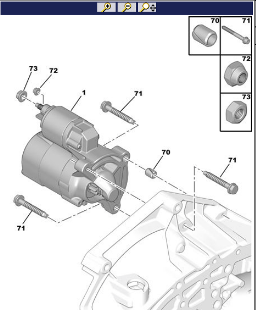

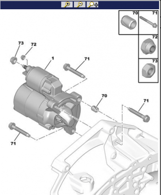

5802 M9 is the part number - there are many brands of suitable Starter motors given that your car is 28 years old.
Available second hand here (I appreciate you are in Greece and that there isn't an eBay in Greece)
https://www.ebay.co.uk/itm/Peugeot-206- ... 2056002214
But search on that part number and you should get plenty of options. I can't see any relay

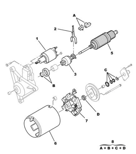

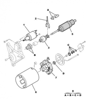

| Here's the Starter itself. | Here's the typical insides of a Bosch variant for Info. |

- Posts: 10951
- Joined: 09 Nov 2005, 22:03
- x 1454
Re: Peugeot 306 1994 can't start
The click may be coming from the starter solenoid (number 1 in the right hand diagram above). If so, it is a good indication that the starter motor is faulty. Maybe the brushes are worn out, but these days most people replace the whole unit.
