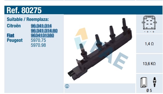

I found the following information on the internet:
Spark coil
supplier: SAGEM BBC 2.2
Primary winding resistance: 0.5 ?
secondary winding resistance: 12.5 k?
And the following FAE information:
I measured the values of my coil and the secondary winding gave 20.2k?.
Given the symptoms may be can be of spark coil?
Spark coil

You really do need to get a Lexia on the car - as you have seen already replacing parts at random has not cured it.
