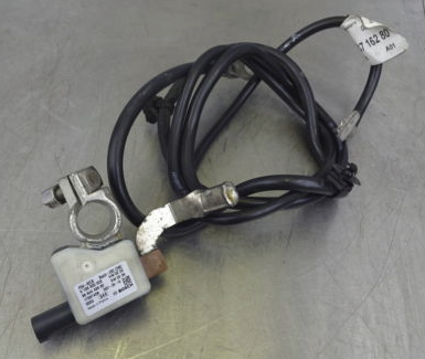

Note: Be aware, you will probably have one of the Battery Charge Status Units fitted onto the negative battery clamps pictured below. If charging on the car, make sure you connect the Battery Charger negative onto the FLAT metal blade to the right of the unit pictured and not directly to the negative battery post itself.
The main function of the battery state of charge unit is to calculate the state of charge of the battery and to transmit this information to the built-in systems interface in order to refine the activation of the energy economy mode.

Re: 407 TPMS Valves
I never knew this, although it makes perfect sense. The last time I charged my old battery it was directly to the battery terminals. That probably didn't help the economy mode issue!
- x 6963
Re: 407 TPMS Valves
Yes it's not obvious by any means, but I think important to note Elis
