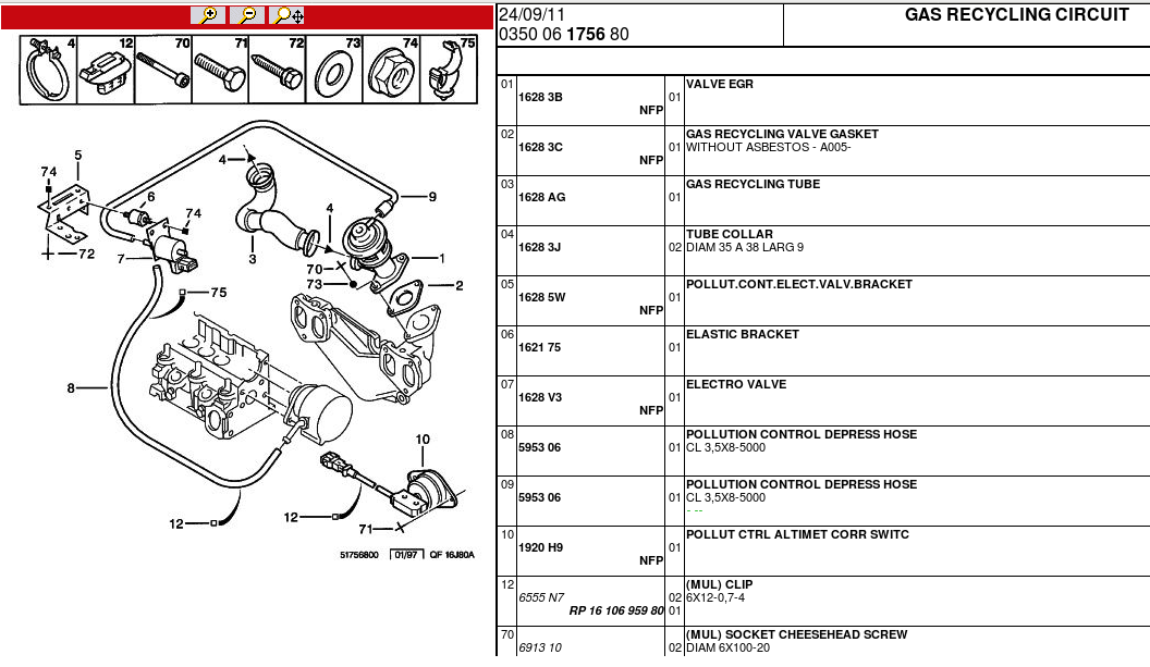

My P reg (late 1996/early 1997) Synergie 1.9TD has one:
EDC5
