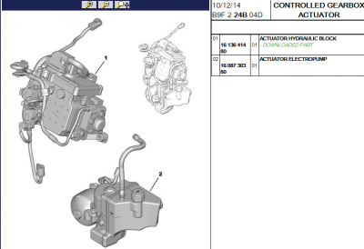

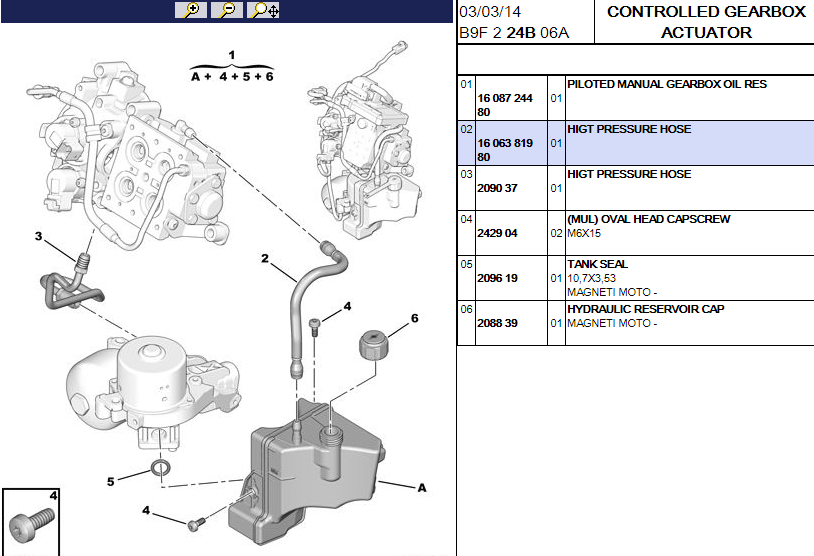

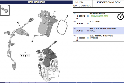

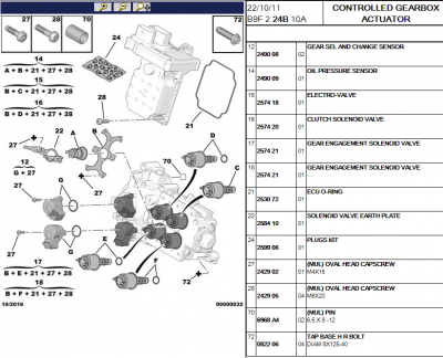

No problems, I'll have a look to see if anything you describe is obviously available - but are you getting any warning lights? There may be some fault codes stored in he BSI that can be read with Diagbox - which will give you an indication. I know this is not what you really want to hear, but there are very complicated systems with electro hydraulic actuators, pumps, hydraulic blocks and calibration routines that generally make these systems a specialist repair if anything goes wrong. You'll find a lot of the dealers may not even bother with a repair, but simply suggest replacement of the components and they are not cheap. Here are just a few of the parts prices - and there are lots of them - so when you add the labour on it can become very expensive down the line.
I'm not sure what sort of warranty you have on it, or how long you have had it, but either get everything done under the warranty to your utter satisfaction, or reject it while you can.
£200 Pump
£771 Hydraulic Unit
£690 Electro pump
£362 ECU
And the list goes on...
Here are some of the parts for your reference in case you are interested, which don't include the actual gearbox or the clutch which are separate.
£200 Pump
£771 Hydraulic Unit
£690 Electro pump
£362 ECU
