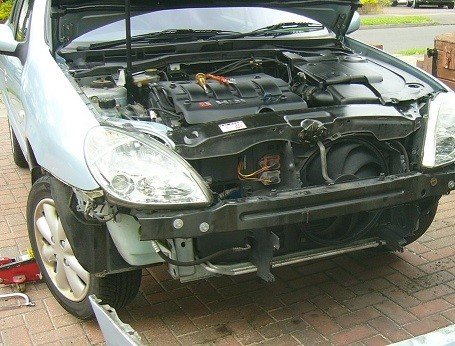

I cant help with detail of the job but it wouldn't surprise me to know that the front bumper needs removing. It was so on the Xsara because the headlamp had two fixings along the lower edge. Also the cross member had to be loosened and lowered at one side to reach the fixings. They don't make it easy!!!

Thank you for the replies, I finally got in touch with a family friend come mechanic, and he's pretty much confirmed what I thought anyway, Might not have to remove the bumper completely but loosen it enough to get access to the two lower bolts of the unit.
