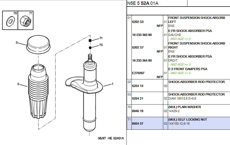

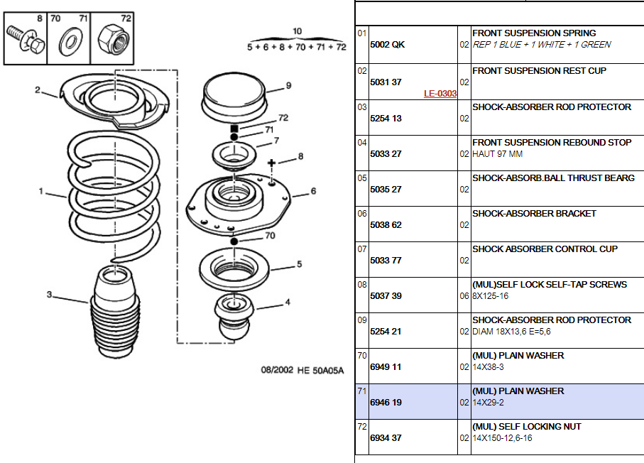

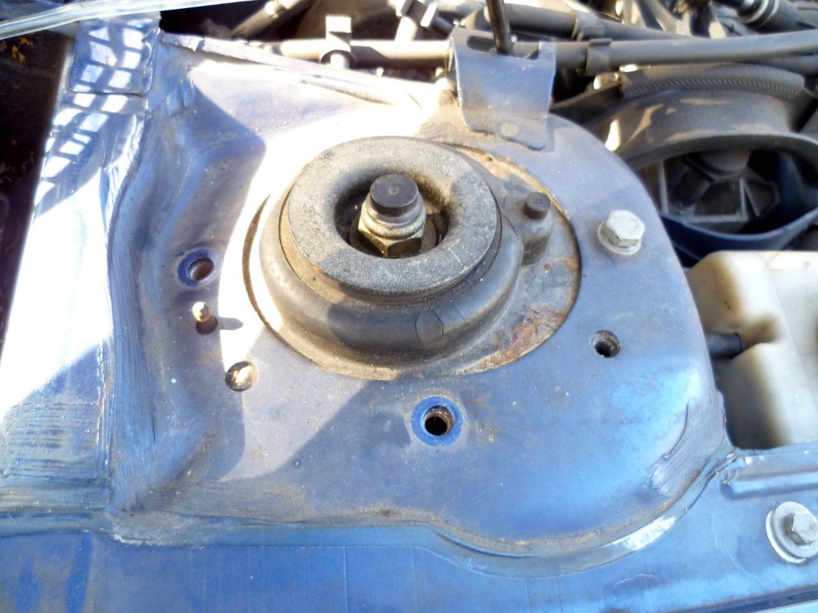

I am glad to spot my front spring a tiny crack it was about to break soon. I am decide to overhaul change all new strut and new spring plus both rubber top mounting, but I do not know what to called this metal round my current is very rust need new one, I have never find any on eBayer Eurocarparts and Carparts4less! I do not want to purchase from dealer it going to be too expensive. Is anyone know the number or a name of this cap?

Re: 306 issue with rear suspension
Hi
Here are the suspension parts diagrams (click to zoom), I think I still had your VIN from last time. If you want to know dealer prices (for a comparison), list the parts - they are not always more expensive than on the web and in some cases cheaper!

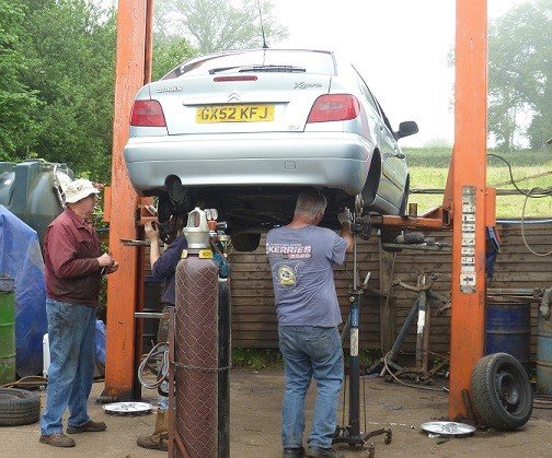

Paul-R wrote: 01 Jun 2018, 14:58 There is at least one company in the south-west of England that can repair the axles.
When my daughter ran a Xsara, one of the tyres started rubbing on the wheel arch. As a temporary fix I glued four washers onto the inside of the wheel rim. That moved the tyre away from the arch slightly. However for a fix I decided to run the car down to Devon where an elderly guy who lived out in the sticks, and his two assistants took off my old axle and fitted a recon one, whilst I and the owner chatted over coffee. Same price for fitting as it was for delivery and collection. The whole job was completed within a couple of hours and I was on my way home. All this was seven years ago and the owne has retired but this company is probably run by the old guy's engineers. http://abaxles.co.uk/en/about/
