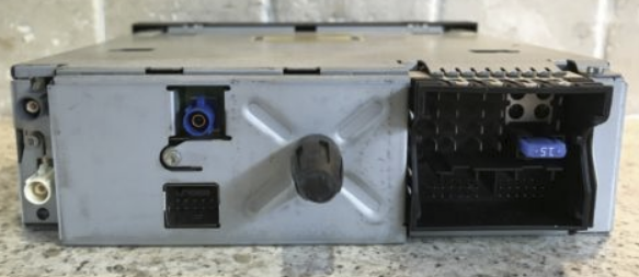

Hi Steven - the GPS aerial is routed to the stubby roof aerial (which you should have) - water can get into the base unit and upset things. It might be worth taking the unit out carefully and checking the GPS connection at the back (you'll need the blade style keys to remove the unit).
Always disconnect the large Quadlock connector first before any of the other connections (especially the screen connector) and then do the reverse when re-connecting as the Quadlock contains the power and should always be removed first.
The GPS will be the Blue connector as shown below. If you have access to another GPS type aerial you can always connect that up and test it - or simply buy an aftermarket GPS aerial with receiver and just tuck the receiver away.

GiveMeABreak wrote: 30 May 2018, 18:34 Hi Steven - the GPS aerial is routed to the stubby roof aerial (which you should have) - water can get into the base unit and upset things.
Thanks for the reply. I had a look at the aerial and the rubber around it does look quite weather worn. I assume that I can purchase a replacement from somewhere and do a straight swap? (I had a look under roof and could see the bolt it is held on with, and 2 wires coming into the car?)
Where can I pick up the removal keys?

GiveMeABreak wrote: 30 May 2018, 18:34 If you have access to another GPS type aerial you can always connect that up and test it - or simply buy an aftermarket GPS aerial with receiver and just tuck the receiver away.
What should I be looking for in an aftermarket GPS aerial? (Google threw up a raft of options)
I think what you're suggesting is that I just need a GPS aerial for blue connector, and FM will still be channelled through the existing aerial (as it is still working)?

Yes that is correct - however if you have already tried that with the first one you got with no success then the problem may well be with the unit itself. The FM aerials are in the adapter part 10 in the diagram I showed you and are not affected.

GiveMeABreak wrote: 04 Jun 2018, 21:40 Yes that is correct - however if you have already tried that with the first one you got with no success then the problem may well be with the unit itself. The FM aerials are in the adapter part 10 in the diagram I showed you and are not affected.
I've not tried a gps antenna yet.
Blade keys just arrived today so managed to check connections at back (Fakra?) before going online for antenna.
Any recommendations as to the type?
Amazon had quite a few standard looking ones around £5-£10.
