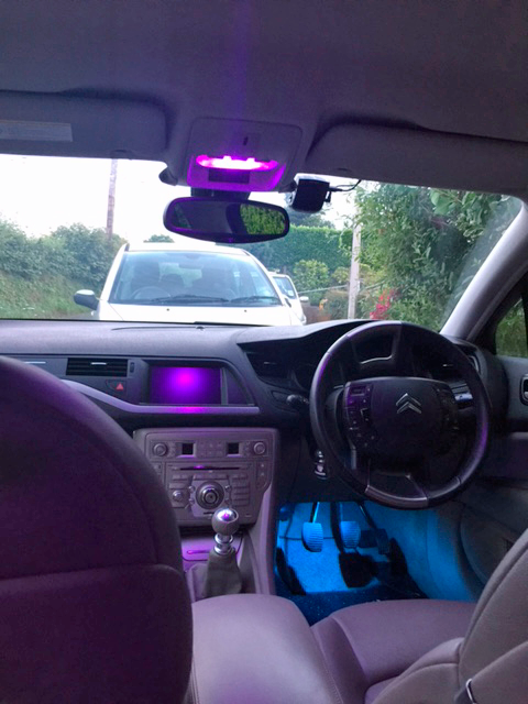

I've replaced most of the internal LEDs too:
A few older shots - the photos make them look worse than they are - not a 'pimpmobile' I promise! :rofl2:

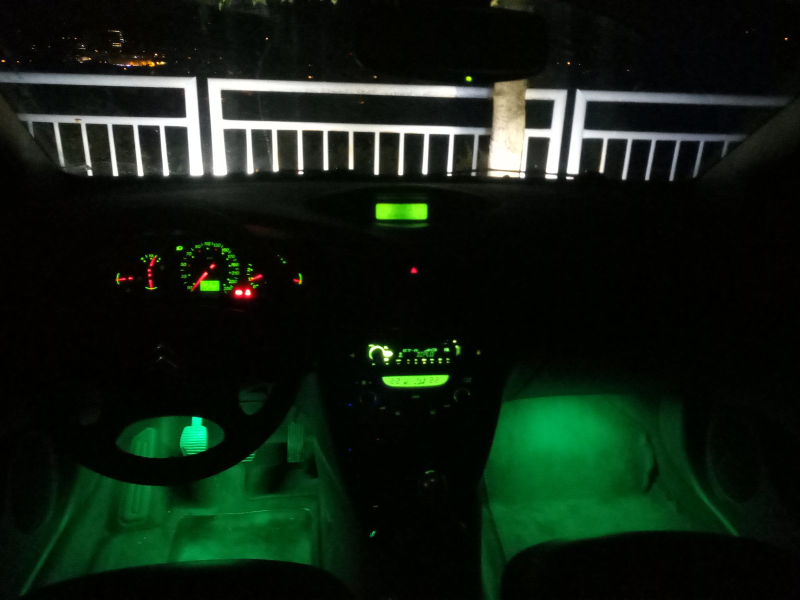

Some pics of my current setup (I know pics are not best quality sorry for that):

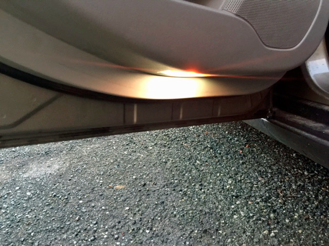

When you open door insted of light is this:

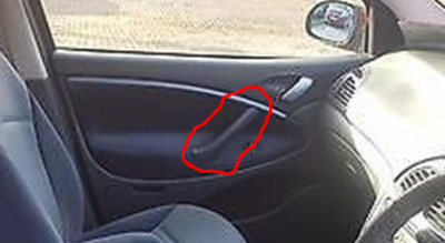

4.) Repainted inside door handles

Only one thing to add, that tt's fine to use an after market (non OEM) bypass relay on a C5 Mk1 - mine has one.
As for the door handles, I haven't seen the covering on them fail in the way that X7 and other newer Citroens fail (a thin rubber coating that has absolutely no durability) but they do have a habit of going 'sticky'. I've just cleaned that off easily with a damp kitchen scouring sponge.

Unread post by DoomsDay »
Thank you for the feedback! :) Yes I also got rid of that stuff on door handles, then just sand it with 400, then 600, then 800, 1500 and 2000 and painted it black and on top of it put some clear coat-ish spray so its good enough now and should last some time :) I have 2 mayor issues now tho.... I tinted the windows and almost finnished doing the towing thing on and then I went to do homologation for windows tint... They were very surprised that I did it myself acting like its very hard thing to do and stuff. However problem is, that I need "tint certificate" in order to do homologation.... I was/am so pissed off bec I cant get it for some random window tint purchased on ebay. U can get it tho from certain people that "they" know and can give it to me, but of course need to pay quite some money for it... Same goes for fricking towing bar. For window tint I will just "modify" one from the internet or something, but what do you guys sugfest about towing bar? I have no clue where to get certificate for that. I have no clue what brand or anything is with that. All I know is, it is for C5 2001-2004 and that it is "hidden". You cant see it unless you get down on your knees and look under the car. Suggestions needed guys :)
