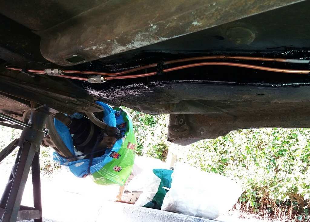

Finally got around to removing the rear calipers on the Xantia, as it was squealing like mad and a little bit crooked. Bolts came out beautifully and the offside caliper posed no issues, however the nearside union on the brake pipe seemed a bit snug, it was only after turning it a bit futher and seeing the paint flake off that i realised i've twisted the pipe about 90°.
Have managed to get the caliper off without damaging it too much more, but is it likely to go bang now i've messed with it? And whats the better option, try and flare a new line and use a joiner to add into the existing line or get a whole new line made up?
Xantia nearside rear brake pipe twisted

It''s always better to go back and make a line to next connection. Wire brush those joints at brake pipe and plus gas them to try and break the fusion. A little wiggle (not you) back and forth to break that bond, then more plus gas. Have you got the tools for flaring the lines? If not garage will make one. You can measure with string, or take old pipe to them.
You are best with your own tools. Draper make a nice little unit. Those Draper type ones on Ebay are about £32 and work well. Last you a lifetime.

A couple of years ago I wanted to put new front brake hoses on my daughter's Pug306 and messed up one of the unions and was unable to get it off. I bought items off ebay similar to these two then cut back the brake pipe to a suitable place where I could do the flaring comfortably under the wheel arch. It made a first class job.

Ordered one from Pleiades in the end for £20 posted, with 10mm hex on the unions instead of 8mm.
Managed to fit the system back together with the line as it is and it seems to be holding pressure so far so will be driven with that in mind until I get a day to route the new pipe

Just a quick 'Thank You' to John D with regard to the Brake Pipe Flaring post.
Me thinks I'm going to be sourcing something very similar shortly having had a fail on my Dummy MOT today*.
I've got a leak from a corroded Brake Pipe which needs prompt attention** and a less severe "Brake Load Sensing Valve Inoperative, Linkage Insecure" issue.
This is a new one on me and possibly explains why the spring keeps falling off. Anyone heard of this before? I've not got underneath it yet to examine the issue and am rather hoping to repair the Linkage rather than have to replace the LSV with all the aggravation that involves, eg getting the Unions undone and perhaps an awful lot of Bleeding.
My aim was to 'transfer' my MOT from Feb to Aug. That's not quite worked out as planned but at least I can take my time about the LSV job.
The only good news is, I've still got a clean sheet on Structural Fails / Advisories, but I know that its by no means perfect on its underside .
*Basically an MOT, but without the VOSA part, so you can't possibly get a new ticket. Potentially a waste of £40, but with a House Move looming I was prepared to take the chance on paying twice and after 2 weeks welding in atrociously hot conditions, enthusiasm for car repairs is running thin.
**I'd noticed a drip, and I'd thought that water had got into my OSR Cill repair, as its in that area; but no, its Brake Fluid.

It is likely that the linkage has popped off because the valve is seized. Good luck, and take care driving it, if the valve is seized giving maximum rear bias, the handling can be rather dangerous (I found out when travelling unexpectedly backwards at some speed through some motorway roadworks).

By that token, would the lack of rear bias in my case mean that the valve's likely OK? I've definitely got a front bias to my braking. I can source a replacement LSV, but I don't want to go that route unless I really must.xantia_v6 wrote: 15 Aug 2018, 20:53 It is likely that the linkage has popped off because the valve is seized....
I've never had a moment such as that, but early on in my driving career I did once find myself doing a 360 on a wet urban road in a Chrysler Alpine with bald tyres. Thankfully I only hit a kerb. Lesson learnt!
I am taking it extra careful. I'm already a driver who believes in planning rather than braking. I've checked the effectiveness of the handbrake (in a safe location) and will be checking the Fluid before going anywhere if I use it again before its fixed.
Wet here today so no chance to get under it yet. Will order Brake Pipe & Flaring Kit in a minute instead.

I think that the valve can seize in any position, but in my case it was with full rear bias. After the spin on the motorway, the dealer checked the brakes on their MOT machine which only did one axle at a time, and declared the brakes perfect. The car spun on several occasions afterwards before an independent garage diagnosed the problem.

Flaring kit and pipe have arrived in the post today, fingers crossed ! Undoing Brake Unions isn't something I relish, but I have a number of Weapons in my armoury to achieve that.
I'm pretty confident the LSV's OK in itself but having fitted the new pipe I'll be attempting to cable tie or clamp it in the 'Loaded' position and briefly road-test to be sure.... I was confident of it passing its Dummy MOT and look where that got me!! I'll be going proper slowly when I hit the brakes
I'm also going to measure the vertical position of the Arm in the unloaded position prior to jacking to remove the possibility of me tensioning the spring incorrectly.

well, its all come to a grinding halt for a couple of days, one of the Unions into the LSV is a larger size than those I have, and by the time I realised, it was lunchtime on Saturday and Pirtek had just closed.
Monday's 'out' for me so am hoping to source said Union Tues'.
Anyone know if I shall find I can get a new Bleed Valve there too (for rear Drum), or do I need to look elsewhere for that? I've loosened all four successfully but one is not in good shape.

Thanks Guys, we have happiness, including a small rust repair to the floor where the Underseal had cracked and allowed water in. Thankfully just a Wire Brush, Kurust, Paint & Waxoyl affair.
Also pleased to report the LSV Spring is on and has remained so for its 10mile extended test drive with the trailer attached, a dual purpose shake-down run prior to a motorway trip to collect a new lounge suite at the weekend. Correct rear bias was very much in evidence...
The Wing Nuts on my Brake Flaring kit were rubbish and one of the threads expired, but substituting a pair of metric M8 nuts from my stash sorted it. If anyone else is buying one, have alternative nuts available (not Dogs ones from Amazon).
...the whole Flaring Kit is rubbish really, but adequate for purpose, which for a mere £13 is all you ask.
