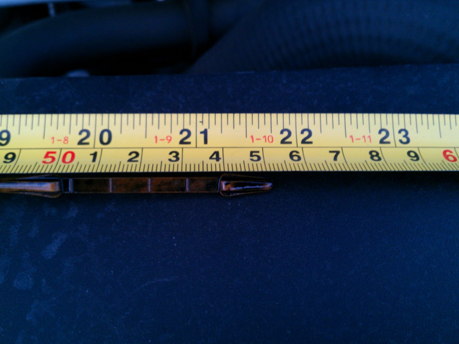

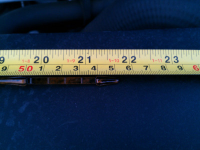

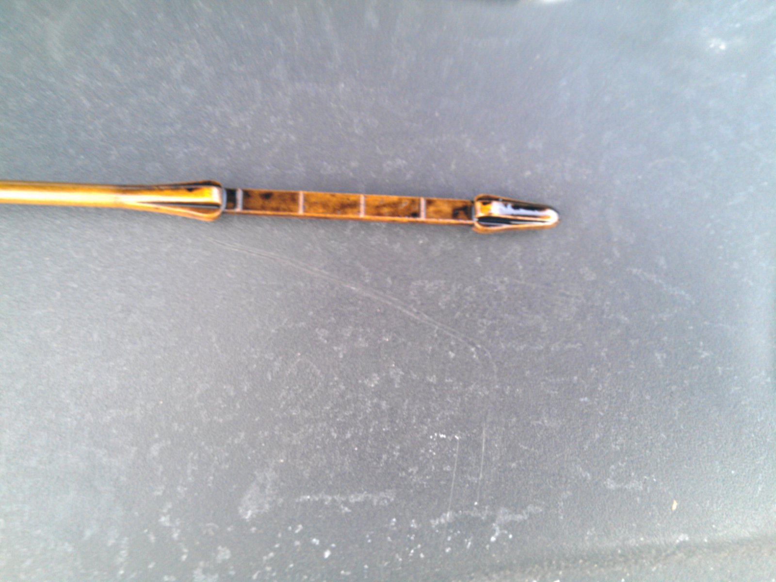

ETA: I just checked my handbook and the oil capacity in my 1.6hdi is a mere 3.9L
btw, my dipstick is yellow plastic too.

MikeT
Posts: 4808
Joined: 11 Jun 2007, 16:17
x 232
Re: 1.6 HDi (Citroen Berlingo) Burning Oil - Oil in Air Intake
Unread post by MikeT »
bobins wrote: 21 May 2018, 19:16 Are these the dipsticks that are known to snap off near the base and make it difficult to get an accurate measurement ?
Not that I'm aware of but anything's possible I guess.
You can tie them in a knot and they won't snap, they're that flexible.
Here's one I made (joke) earlier...
Measured from o-ring to tip = 55cm
