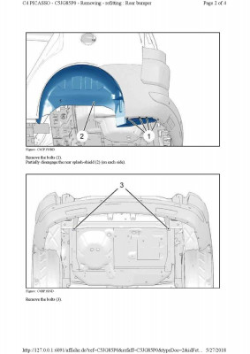

Does anyone have any info for removing the rear bumper cover?

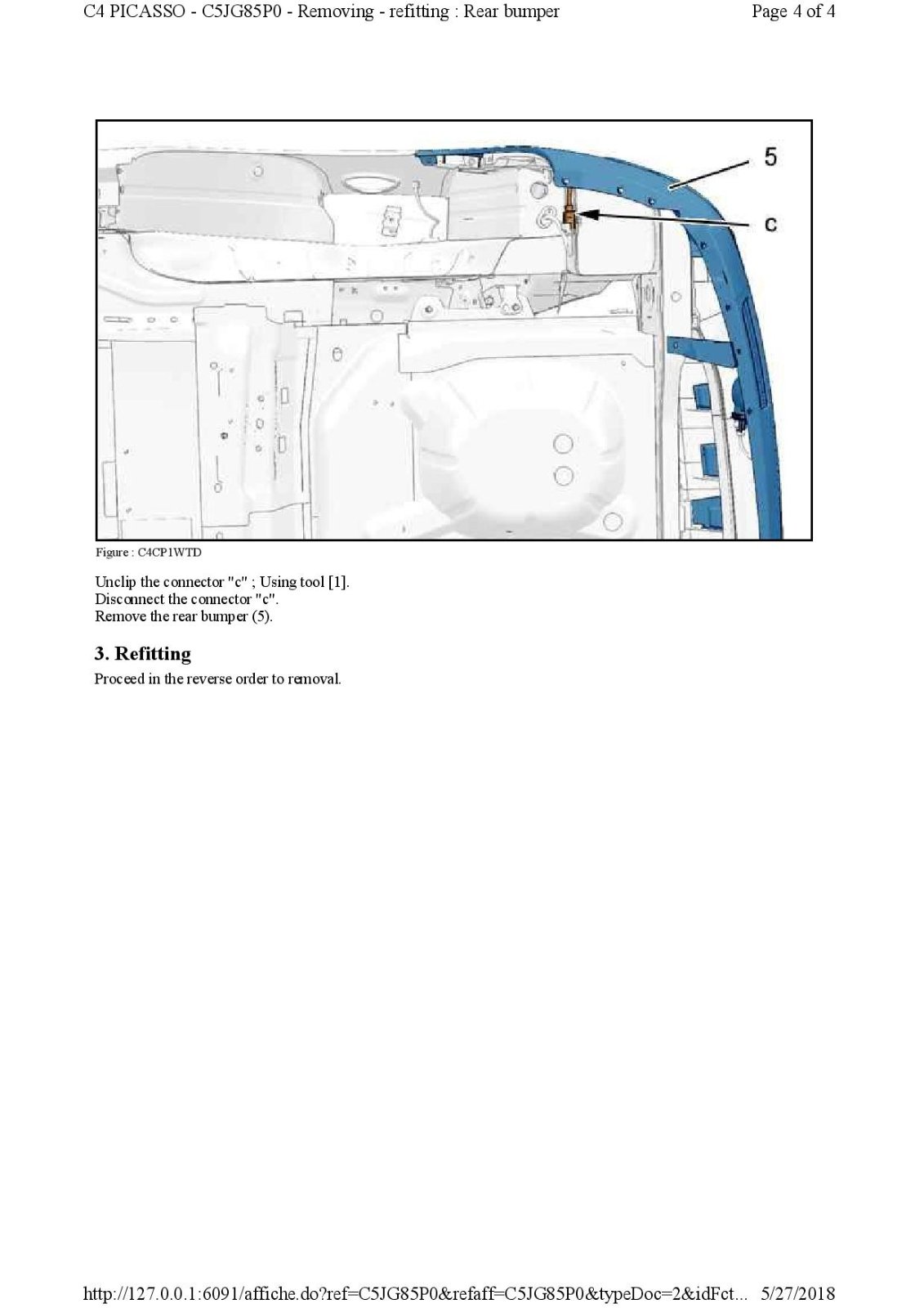

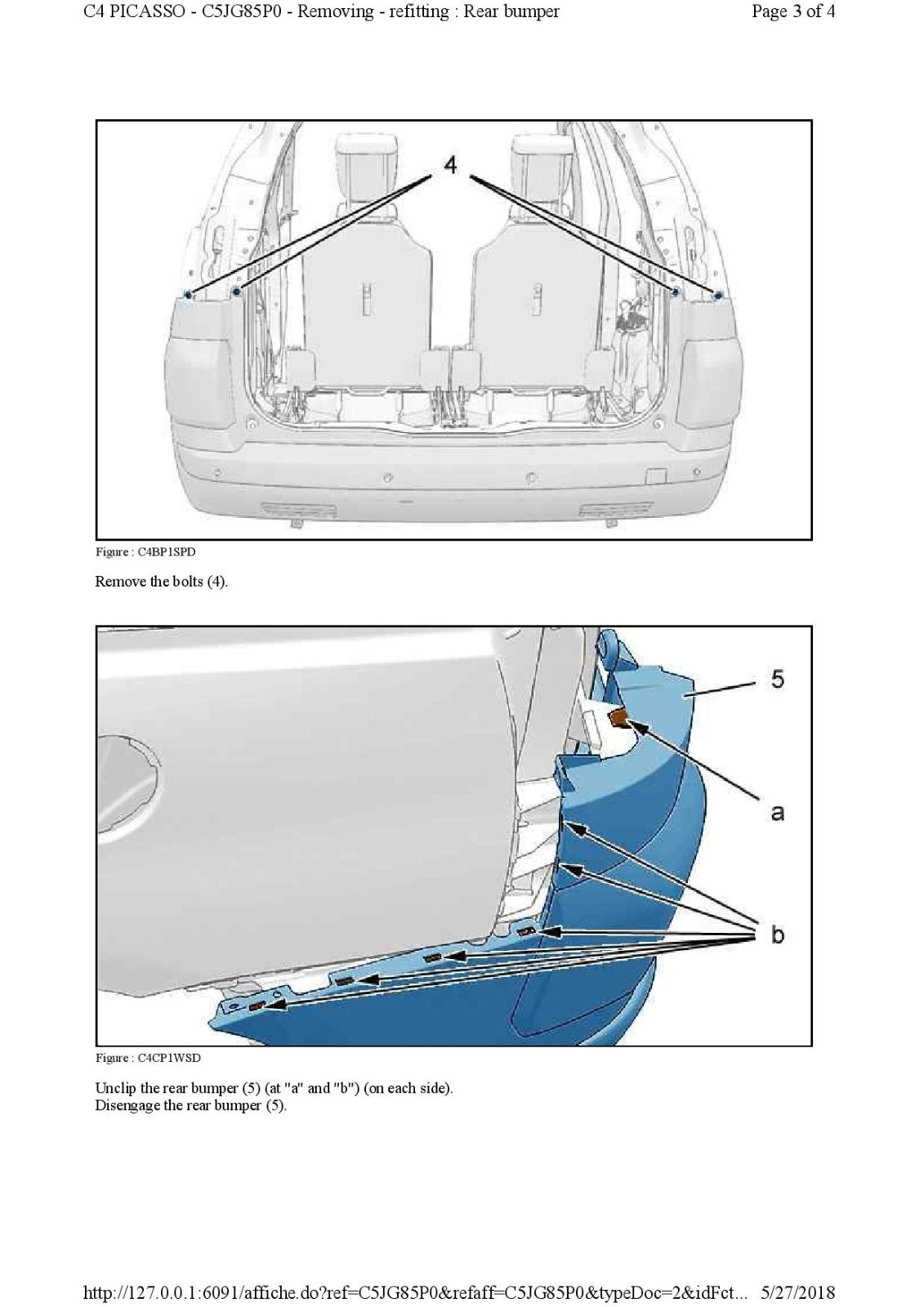

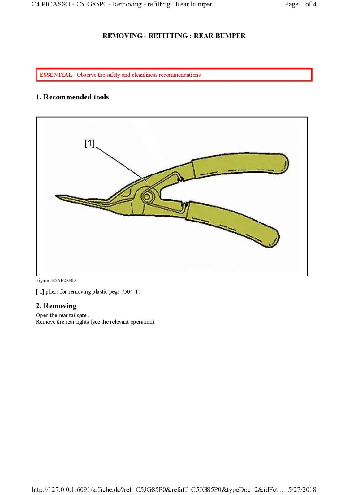

Hi Rosanbo,
You have probably got the bumper off by now, but....
Hopefully it is the right vehicle as my manual goes up to 2013.
This is for a "C4 PICASSO FAMILY SALOON 2.0 i 16v 143"
Good Luck
Bumper Picasso Page 4
Bumper Picasso Page 3
Bumper Picasso Page 2
Bumper Picasso Page 1
