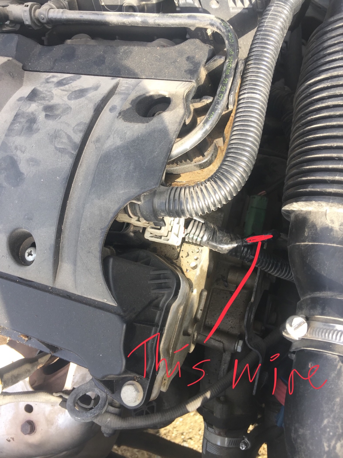

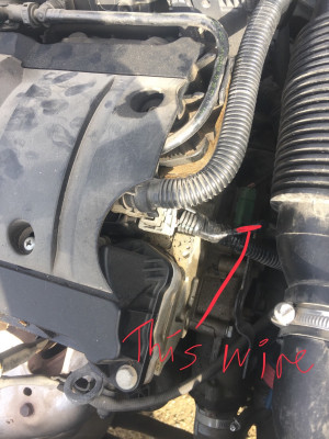

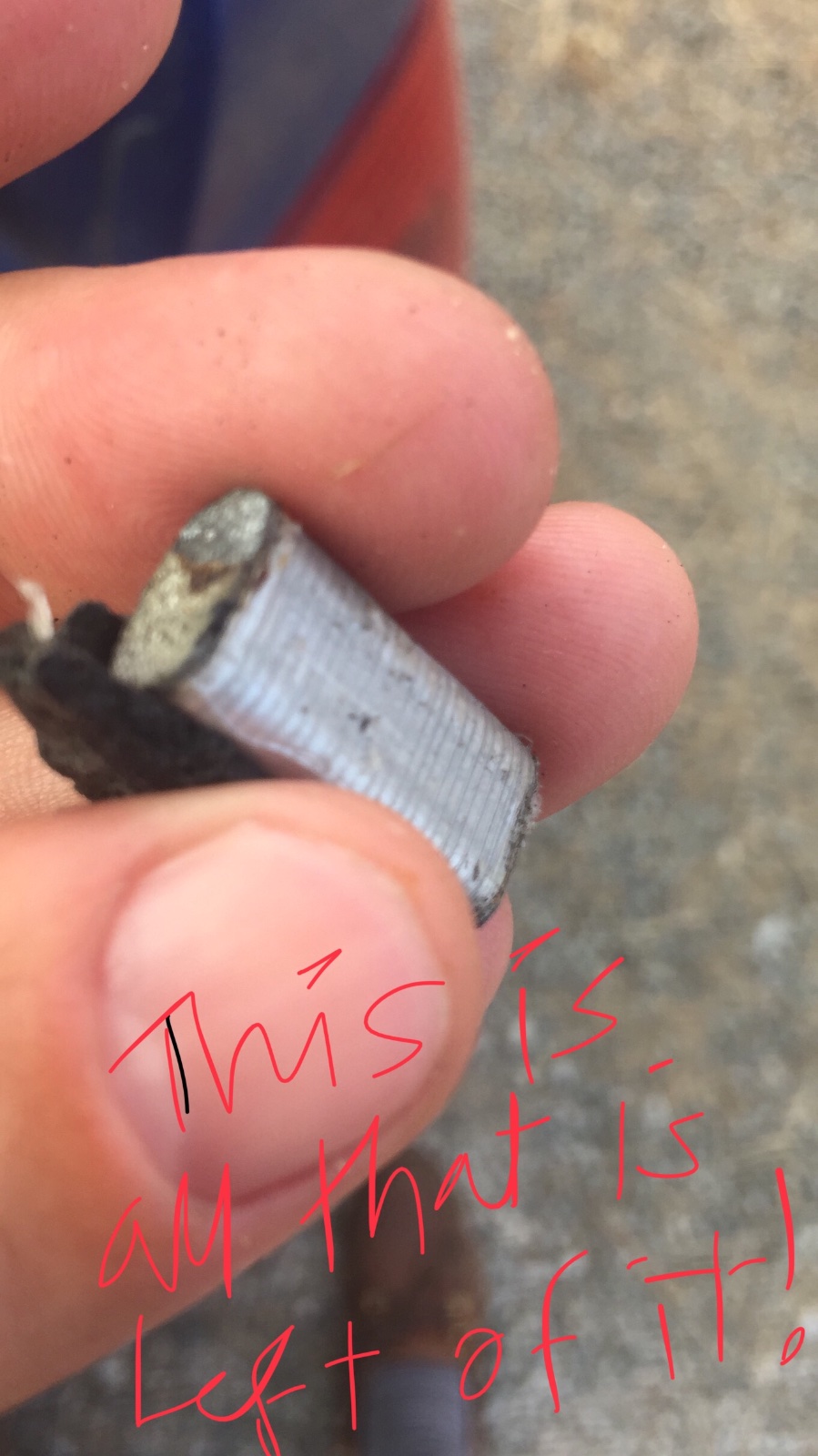

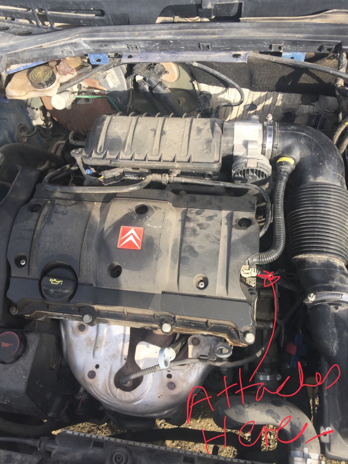

Hi, Please can you help me identify a part.. It looks like a secsor, but it has fallen apart and is dangling...
Here are the photos...
and..
and..
What is it? Do I need to fix it?
Thanks so much guys- William

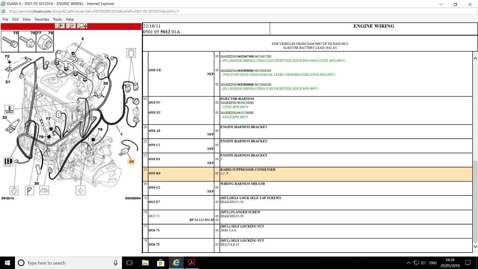

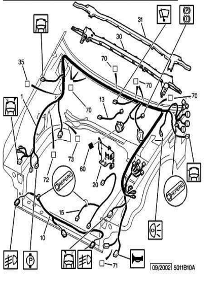

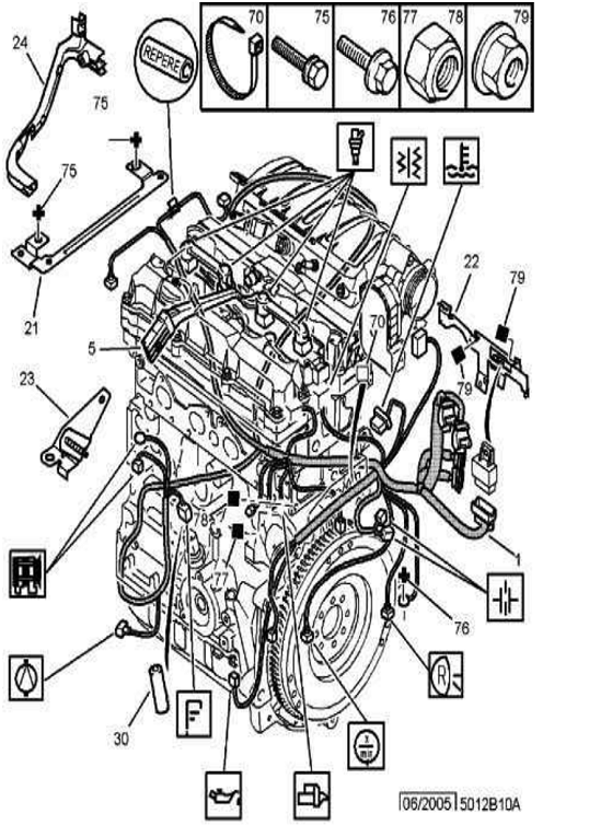

Hi. can you post your VIN - as we'll need to identify the correct engine and equipment fitted.
In the interim, I'm basing the info below on a XSARA II, 1.6i 16V Petrol 110 (TU5JP4) engine.
If you can identify it from these and then PM or post your VIN I might be able to look at the electrical diagrams for further info.
| Front Engine Wiring Harness | (1) Main Harness (10) Fog Light Harness (13) Adaptation Loom (15) Dashboard Fuller Wiring Harness (30) Main Wiring Loom Protector[/td |

Re: Identify Part Citroen Xsara N1 1.6 109HP 2003
Looks like it may be an interference capacitor/suppressor fitted to the coil wiring & bolted to the cylinder head, it may have been added on after manufacture to rectify certain faults. This means it may not show up if you check it by VIN on Citroen service. Some TU engines have them originally & some don't.
The part no for it is 6555K9.
