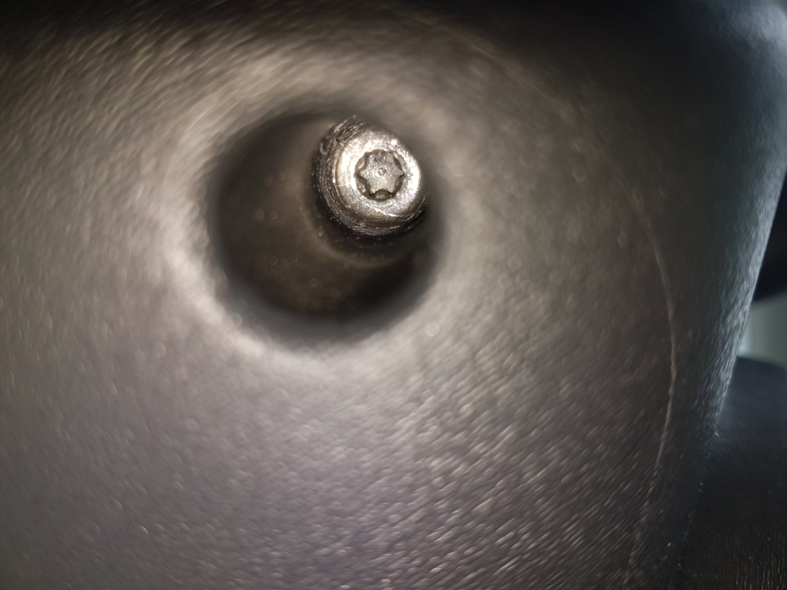

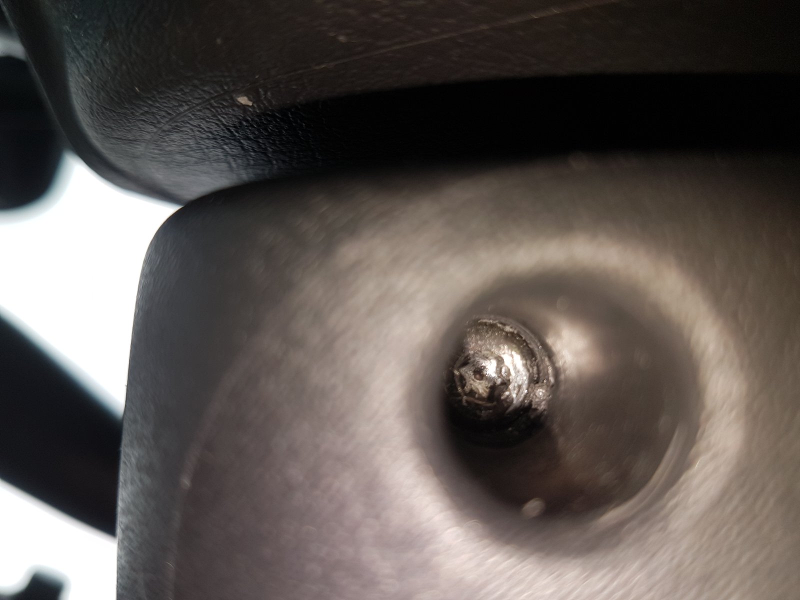

I am trying to remove the steering column cover on the wife's 2004 C3 to look at the faulty indicator ( it won't click into place for a left turn) but I can't really see any screws to undo the cover like on most other cars. There are 2 tiny hole at the bottom of the underneath cover but so small I can't even see what's in there. Taken a couple of pics and they look like very small Torx screws but can't be sure

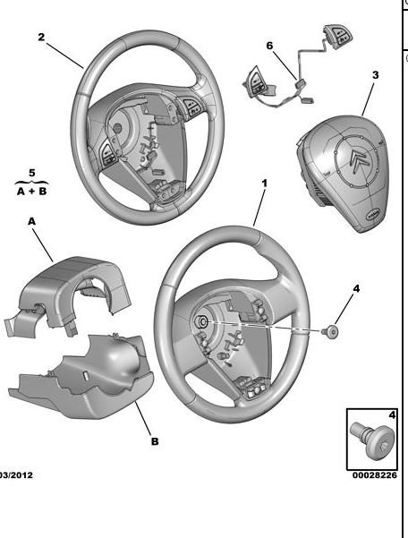

Doesn't look like there are any screws, must just be clipped. I'll see if I can find instructions later:
The fault will be with the COM2000 unit, which has both stalks on it. There are myriad different ones, need the VIN to confirm the right part. There is (or was) a guy in Bradford can repair them.

Thanks for the info. I have tried to prize them apart but no luck. I have added the photos I have taken of the holes underneath item B on your picture. They are clearer than on my phone and they do really look like Torx screws.

Yes, the instructions say remove the screws. I expect they are T20, you will need a long thin driver to get them out!
