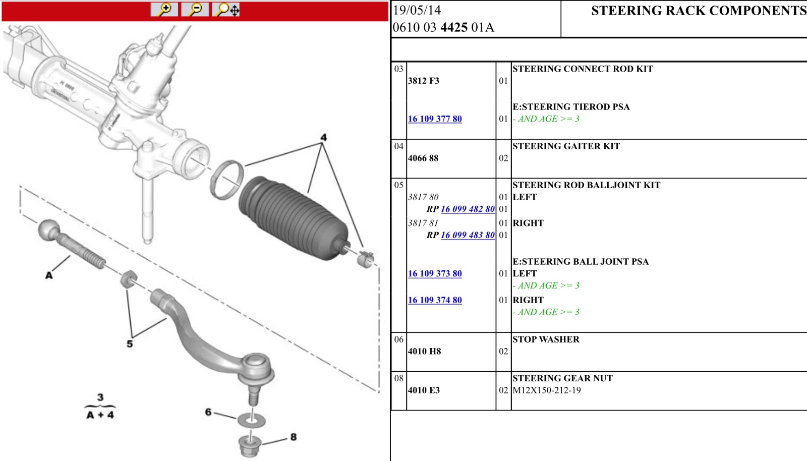

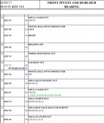

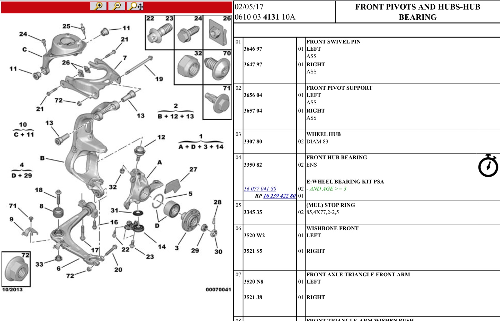

Here you go Pete:
Click to Zoom
x 6958

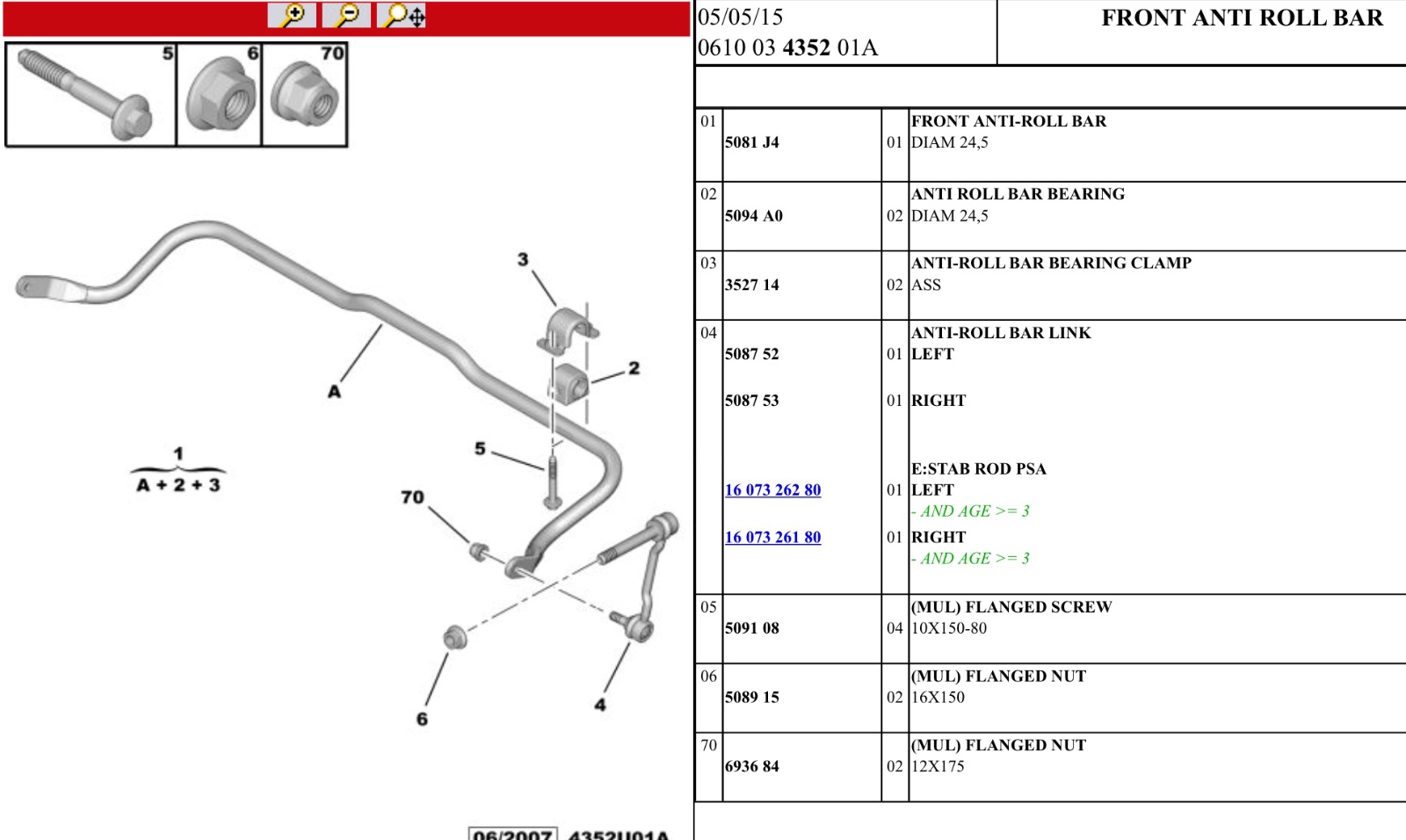

I’m having my Anti Roll Bar joints done, as one has been an MOT advisory for the last 3 years! Managed to source originals on the web at a vastly discounted price.
I’ll put that up here too in case......

GiveMeABreak wrote: 17 May 2018, 14:30 I’m having my Anti Roll Bar joints done, as one has been an MOT advisory for the last 3 years! Managed to source originals on the web at a vastly discounted price.
Marc, any idea what the "E" prefix means for the blue-numbered parts? When I looked up mine, they were significantly cheaper than the black-numbered part.

Marc, its the CV joints that are making the noise, which, unless my eyes are worse than I thought, aren't shown on the pic! :-D

MikeT wrote: 17 May 2018, 14:36
They are alternative parts for cars over 3years. The parts are approved, but not Citroen originals Mike. It’s like if you go to Citroen they offer 2prices for some fixed price repairs, one will be less and they will use the non original parts for a cheaper price. Often referred to as Citroen ‘Originals’ or ‘Essentials’.

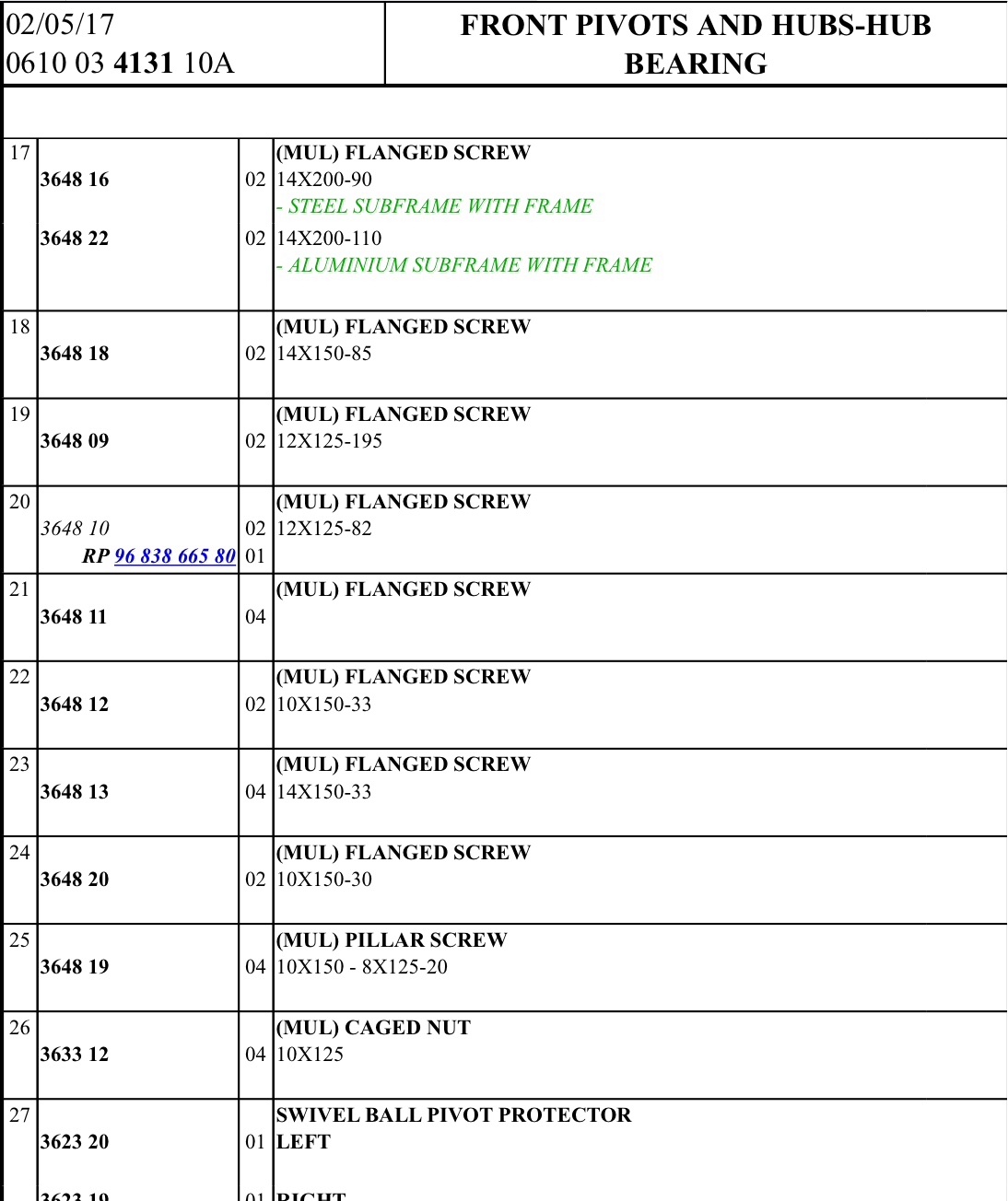

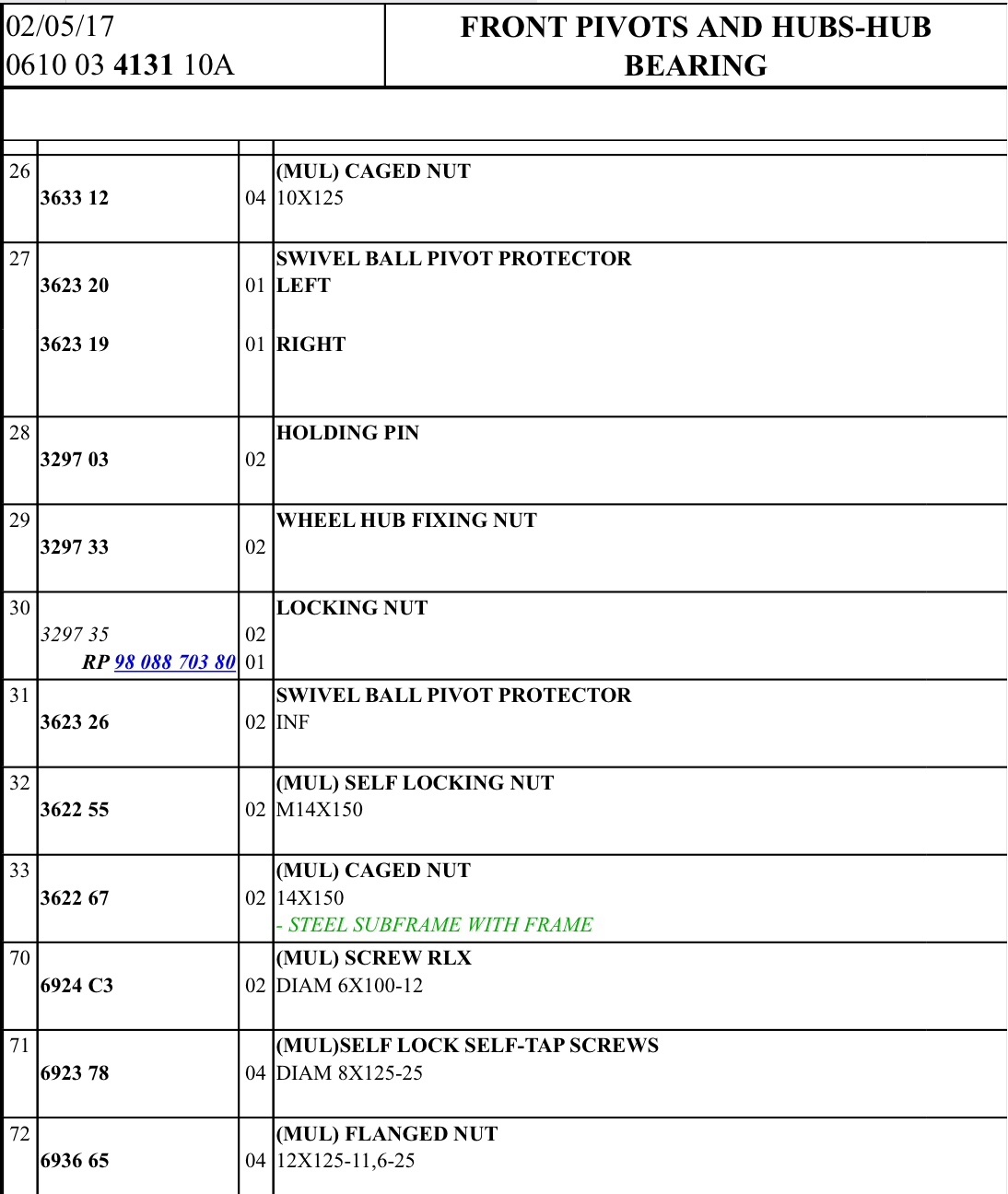

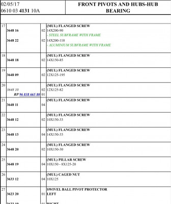

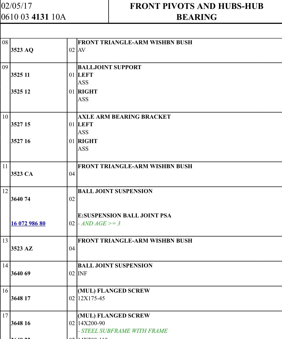

Here’s the rest of the front axle hubs and such Pete, that’s why I put up the ARB links. I’ll have to put these up in sections given the sheer number of parts!! :rofl2:

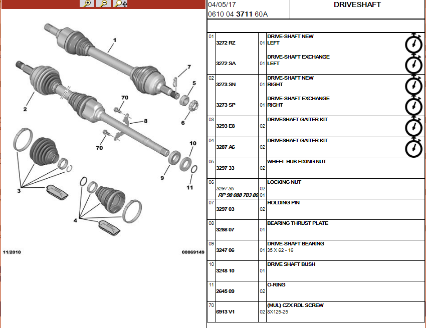

Which still doesn't include the CV joints... :lol:
They're on the driveshafts page, but, not available separately anyway.

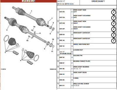

Oh sod it - you should try doing uploads, cropping and tables on an iPad mini! What a top hat I am :rofl2:
