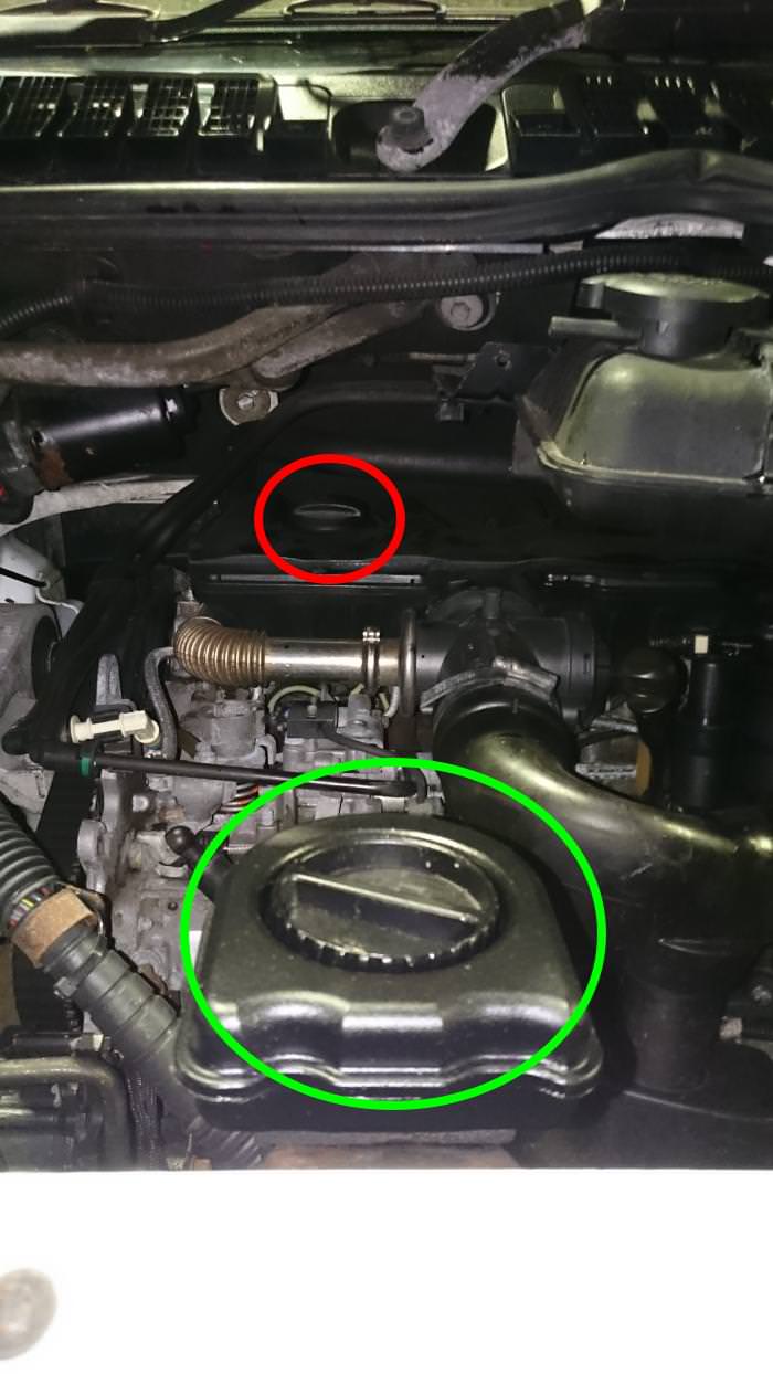

Here's what they look like in real life. No way I'm getting a 5 litre bottle to that one on the head:
Surely I've not been doing it wrong all this time!

You can fill the oil at either point, number 4 & the associated parts have been added to the dispatch due to (as you have found) poor access to the main filler cap.
