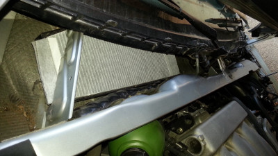

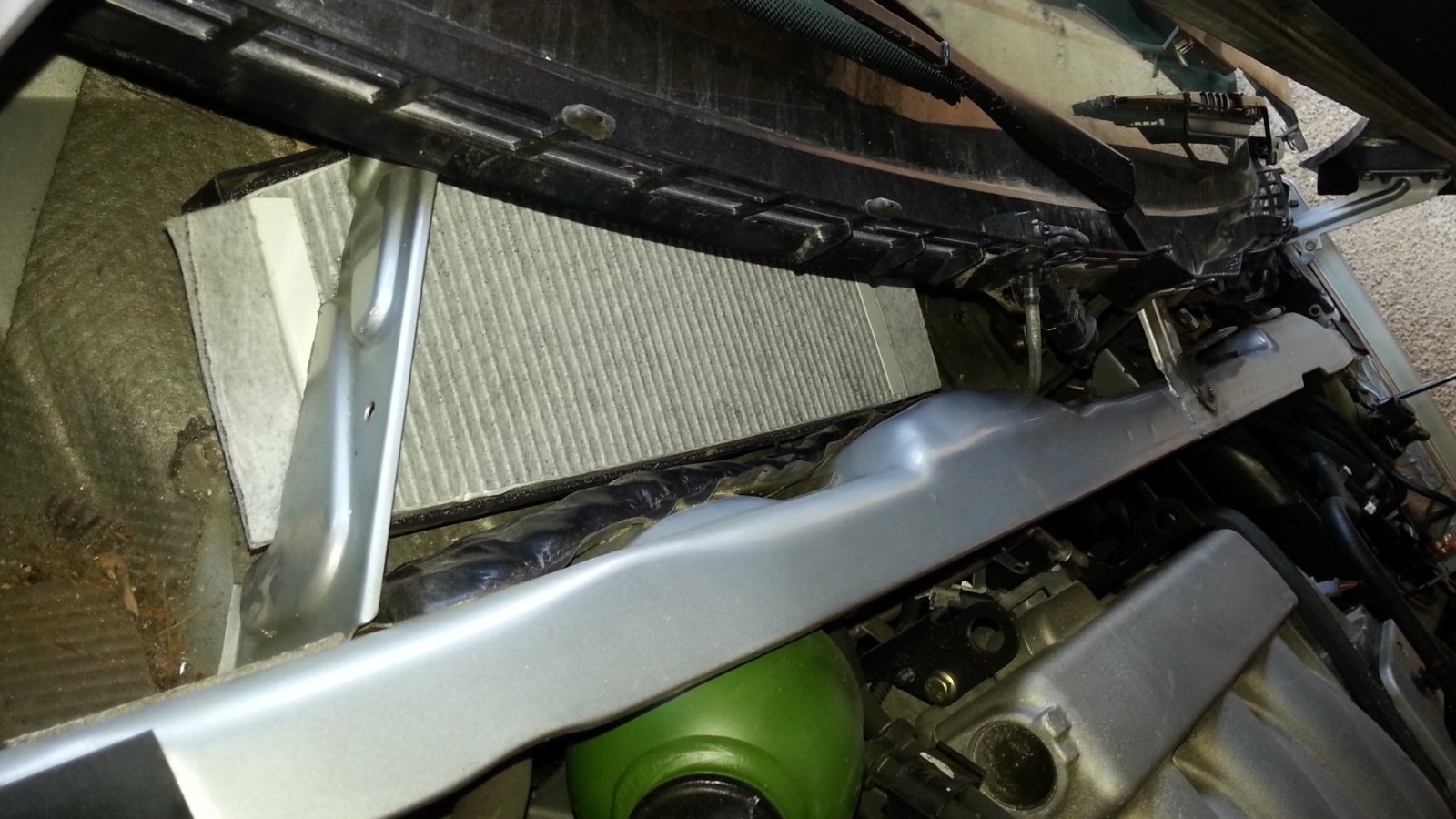

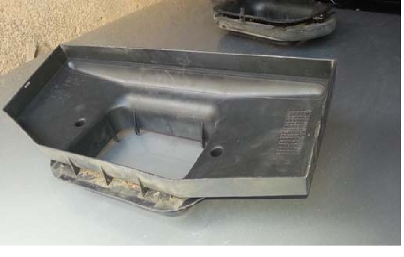

The XM was never fitted with a pollen filter, but it's sister car the 605 (with the same A/C system) was for later production. The 605 pollen filter was simply added at the air intake under the scuttle, and I have retrofitted one to my XM. You may be able to do something similar.

One important thing to keep in mind is that if the filter is on the suction side of the blower, the blower efficiency is significantly reduced by any restriction, so the surface area of the filter should be greater (maybe 50%) than an equivalent filter after the blower.
Posts: 10917
Joined: 09 Nov 2005, 22:03
x 1438
Re: Pollen filter (cabin filter)
Unread post by xantia_v6 »
For inspiration, here is the adapter for the 605 with a filter:
An here it is with a filter squeezed into the scuttle on my XM (before fitting the rain cover):
