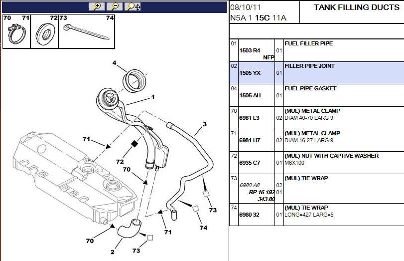

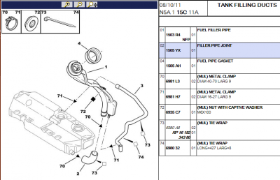

IIRC your VIN ends in 4296? If so, then there are 2 parts to the system, they should of supplied you with the second diagram too.
Click to Zoom the images

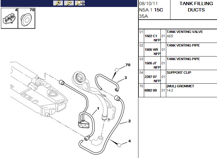

Now in Diagram 'B', your vehcile does NOT have part '3', from September 2000, this was not fitted to your model. It is actually called a 'Tank Degassing Pipe'.
Diagram A | Diagram B |
Re: Fuel cap overflow
Givemeabreak thanks for info and picture my is B now I have understood I don't have them on 2001. :thumb:
