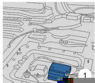

It would be helpful if you had the Lexia Code for the fault as there are hundreds of fault codes - As Gibbo says the Airbag ECU may have a trapped or bad connection. It is located on the floor between the 2 front seats as in the following:
If you can get me the codes, I might be able to locate some further info for you.

Marc has clarified where the ECU is located but it may still need replacing.

I've removed the SRS ECU from the scrapper (thanks for the location). The good news is it only took 10 minutes. The bad(ish) news is that in doing so I ripped the carpet - it's a layer of foam sound deadening, board and then carpet - trying to lift the section over the airbag module snapped the board and ripped the entire 1ft section between the seats out. Looks like when I swap it on the real car I might need to remove one of the seats. I tried doing this on the scrapper a few weeks ago and failed, there are so many bolts I'm not sure which are the right ones to use. I'll google it. At least I know not to make the same mistake on the main car.
