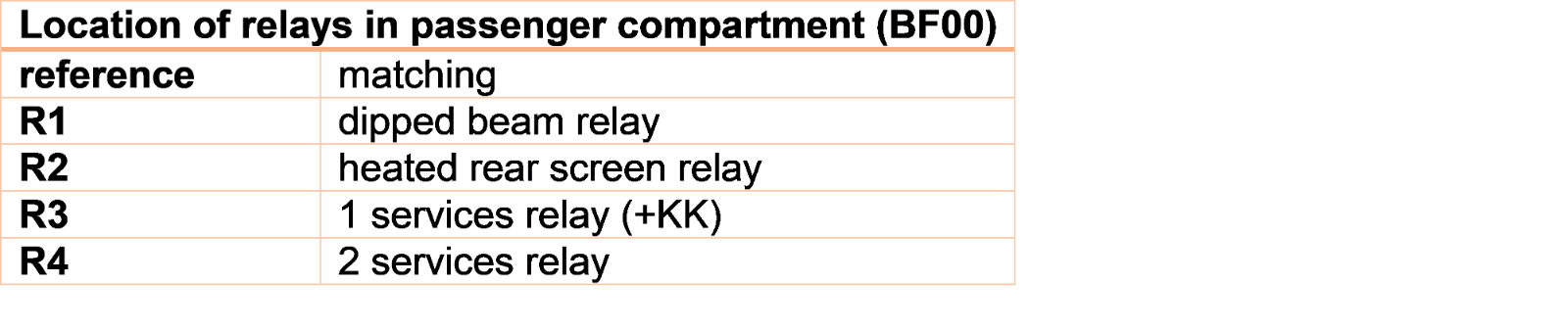

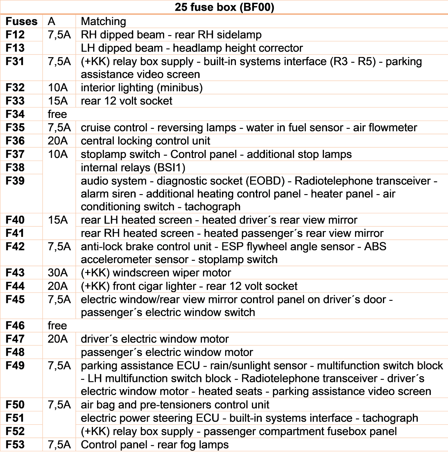

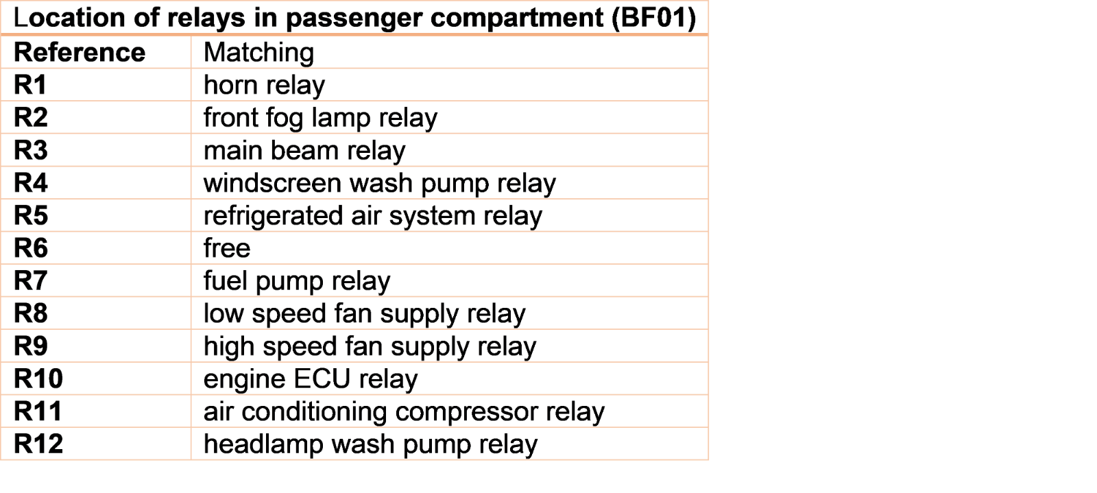

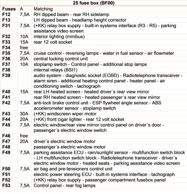

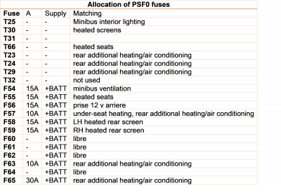

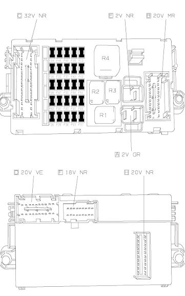

Re: 2010 Citroen relay 2.2 over heating

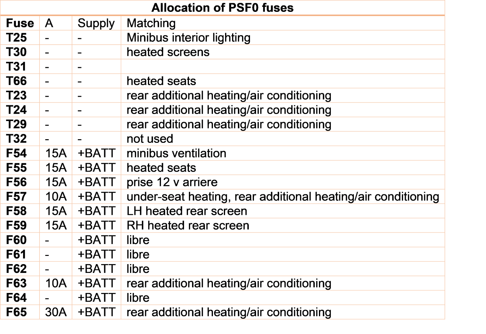

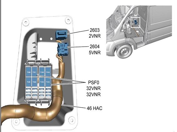

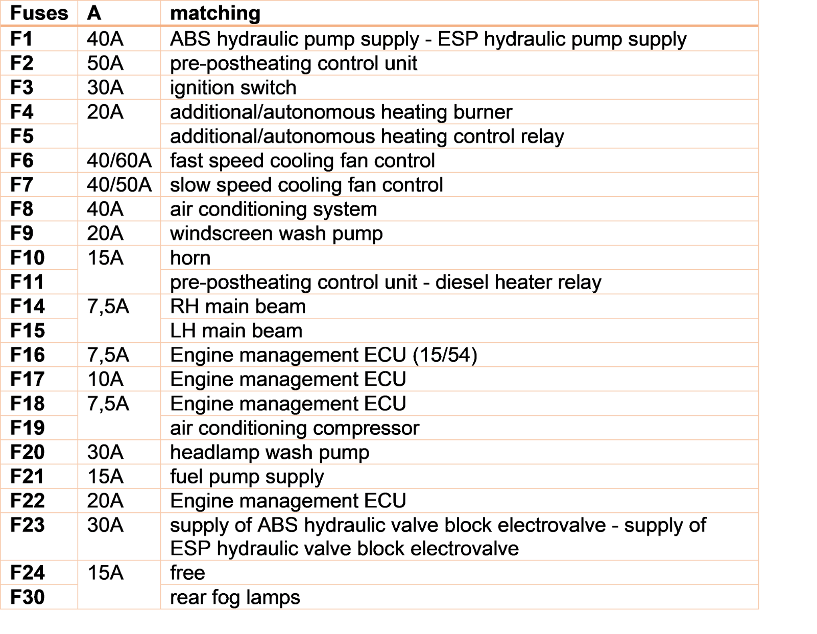

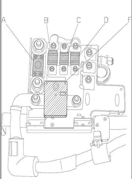

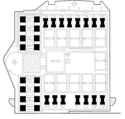

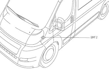

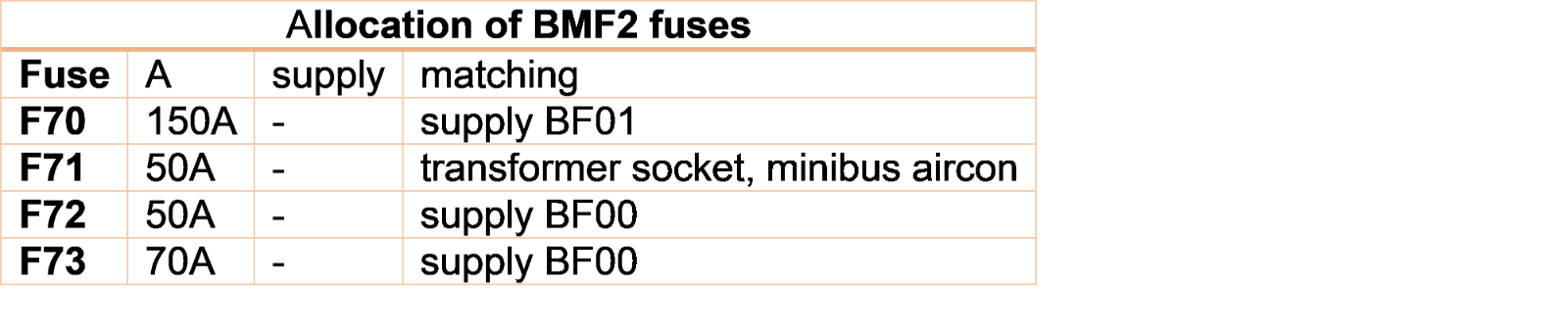

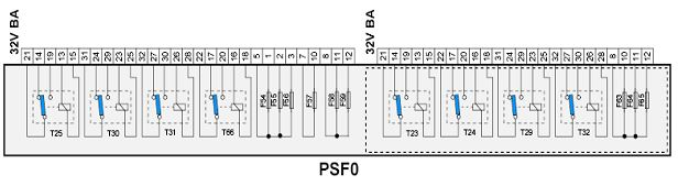

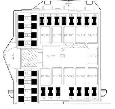

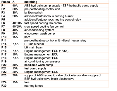

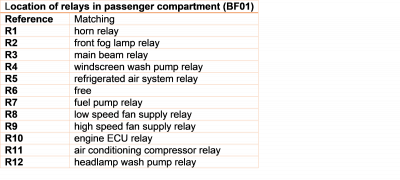

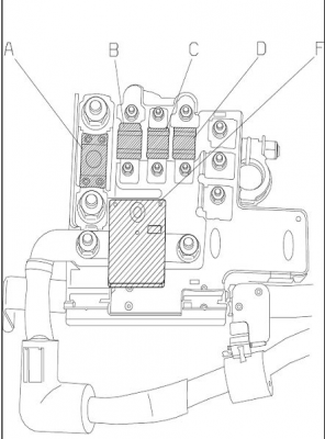

Ok, so here are all the fuses and relays with location and designation - as best as I can replicate them here. Bear in mind you may need somebody with the S1279 add-on module for Lexia when diagnosing the Van as it has the Ford Puma Engine - but I can't say for sure.
At least you'll be able to check the relays are working from the info below I hope.
Click images / Tables to Zoom
