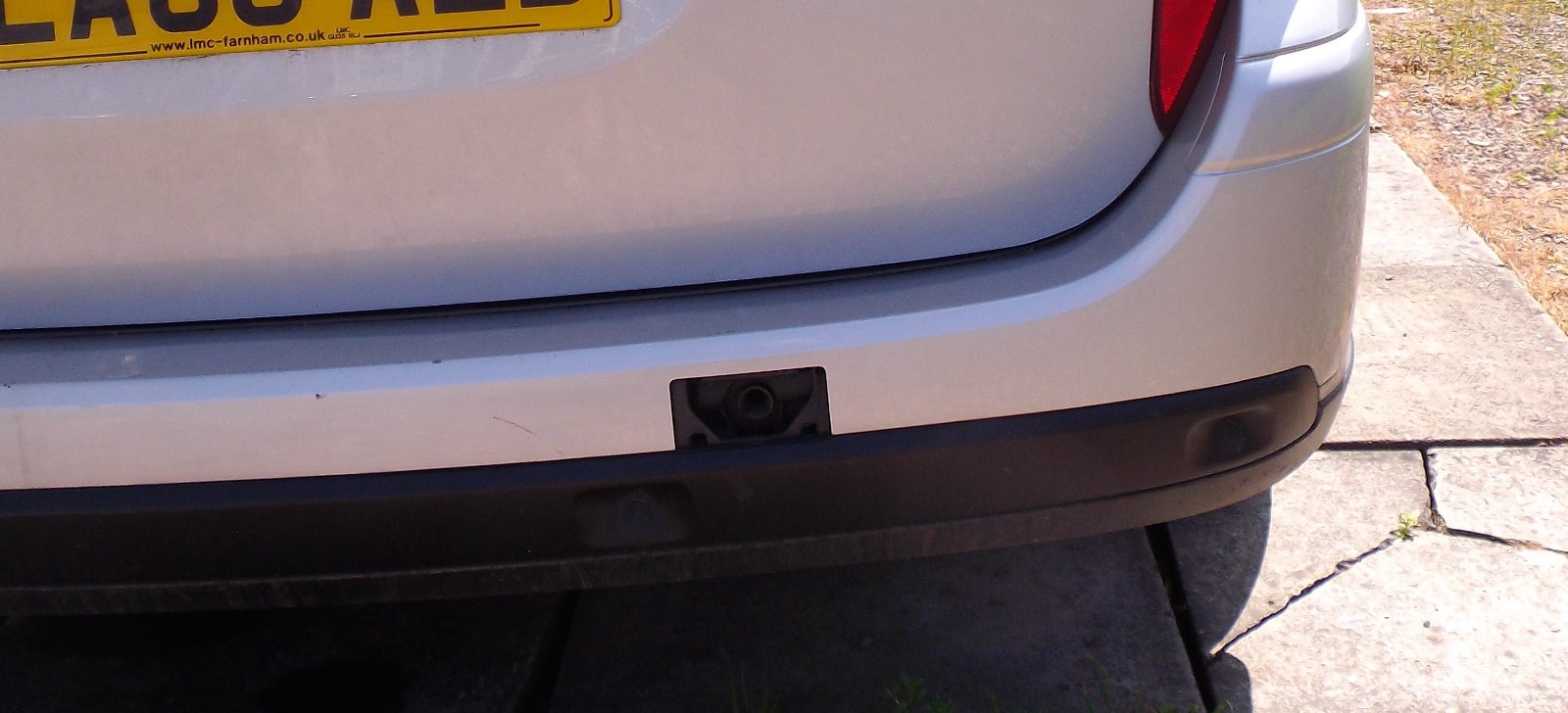

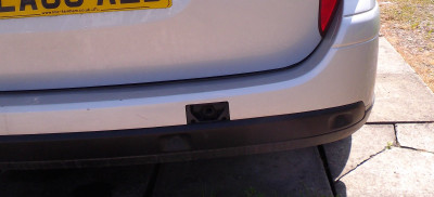

On my back bumper this bit's missing, asked at the dealers and they want damn near thirty quid for it unpainted and need to order it in from the factory, I thought sod that, it's tuppence worth of plastic.
I've got a suitable bit of plastic cut to size but I need to know how it's held in place, anyone know?

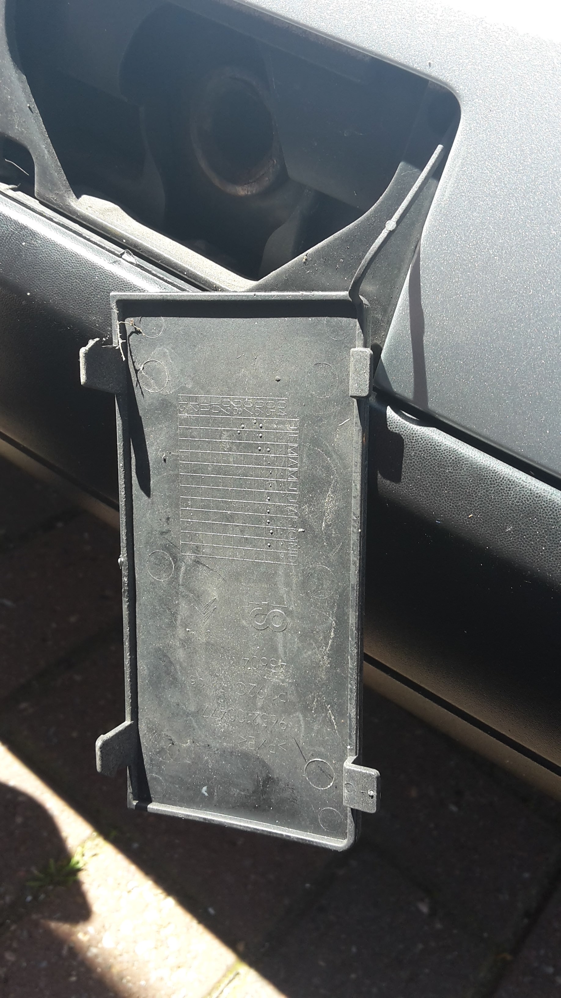

top clips, on right are cranked 90 deg to be parallel with plate, fit these first then the
bottom 2 push in and secure with the hooks at end.
double sided tape, x fingers you don't need to access too regularly!

Thanks old-un, just what I need. :)
