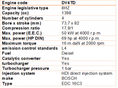

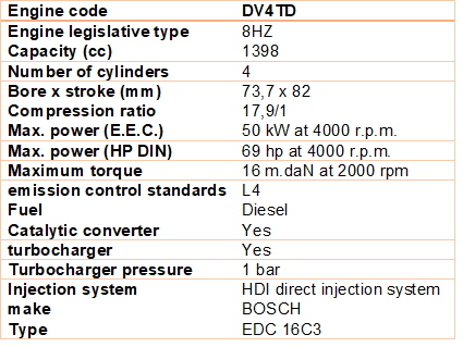

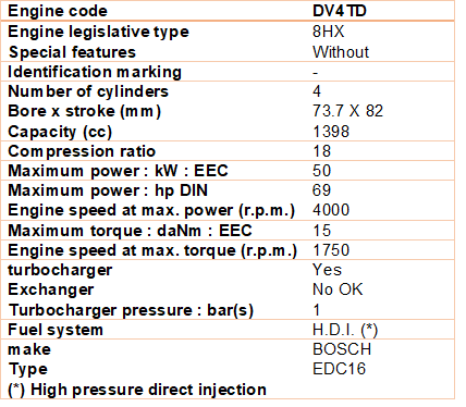

Assuming we are talking the HDi 70:
As you can see, there are subtle differences in the actual engine variation - The torque is less on the 206 variant, but more importantly, the injection system is also different. So I can't say for sure, but I suspect you may have issues with the injection ECU as it will be designed for the different engine. It is also possible that there may be other differences that are not so apparent - especially with the turbo / or other equipment - but without VIN codes for a comparison - it is difficult to say off the hoof.
| C3 | 206 |
