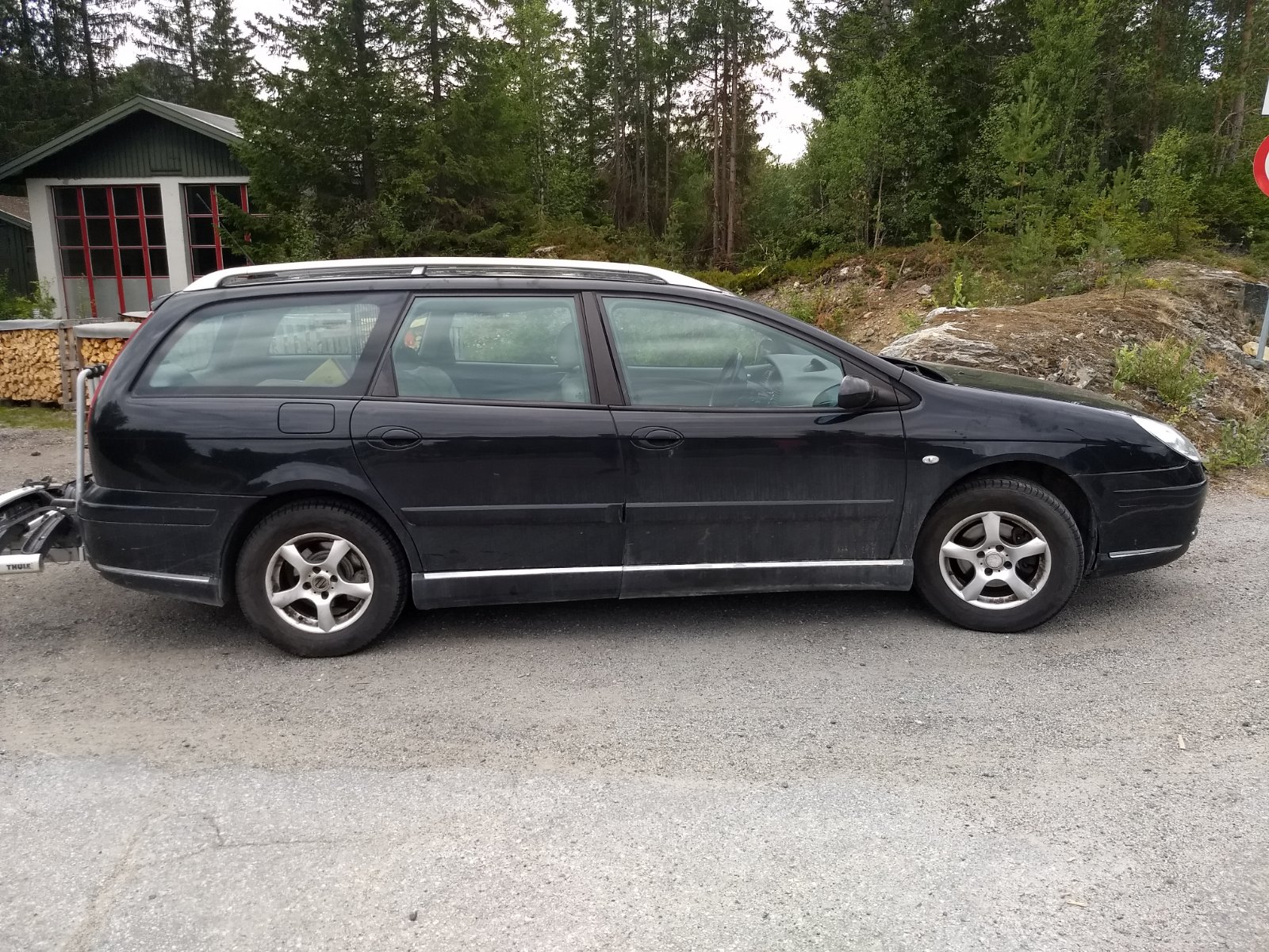

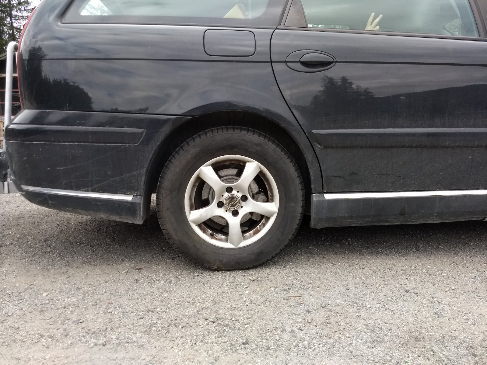

Re: 205/70r15 on C5II?
Unread post by Axa »
205/70/15 on the car. Significant improvement in ride comfort over sharp edges and potholes. No rubbing. And imoh it looks better with the wheel wells filled up a bit more..
