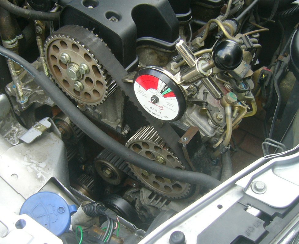

All the pulleys should be the same width and all are a little wider than the belt. My 1.5 is in a Saxo but the same engine as the 106. Here's a picture I took when I was doing the belt on mine.

Many thanks for your reply (the only reply I got!) and excellent photo. I assume that's a belt tension measuring tool attached, is it a mechanical gauge? The one I have is a Laser 4212 which is a digital gauge which is rather fragile and will need recalibrating if dropped or over tightened. It'll eventually need recalibrating anyway after a set number of uses but doubt I'll ever reach that number. Still cheaper to buy than paying a garage to do it and my Xantia Hdi!
My engine is the earlier 1.4 TUD3 engine which is slightly different, mine has a single bolt holding the cam sprocket on and a single bolt on the pump sprocket. On the 1.5 the sprockets are bolted to a hub with 3 bolts and the hub held to the pump and camshaft respectively with a single bolt.
Your belt looks to be running centrally on the pulleys and sprockets, as I should be, with a few mm either side. When I line my camshaft sprocket up by eye it doesn't line up with the other sprockets and pulleys and being narrower I suspect it's not the correct one. Main dealer is no help and tell me they don't stock it and doubt it's available anyway, nothing on ebay so maybe someone on here has one. I wonder if someone's fitted a petrol pulley, when I checked the specs the belt for the petrol engine is 17mm wide and the diesel belt is 25mm. What worries me more is the position of the timing locking pin holes, sure it's different for a diesel than a petrol.

clydeowenp wrote: 10 May 2018, 21:28 I assume that's a belt tension measuring tool attached, is it a mechanical gauge?
Yes - my tensioner is a mechanical Burroughs tool. It's calibrated in Newtons but it's easy enough to convert to Seem units with a conversion chart. From memory I locked the flywheel with a bent 6mm rod, the cam pulley with an 8mm bolt and a 6mm drill for the injection pump. The bolts on the pulleys are in slots and need to be loose on the hubs as the tensioning is done. All the best with yours.
