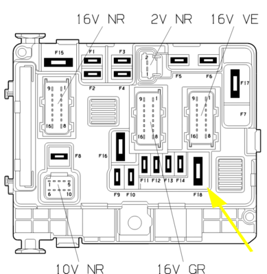

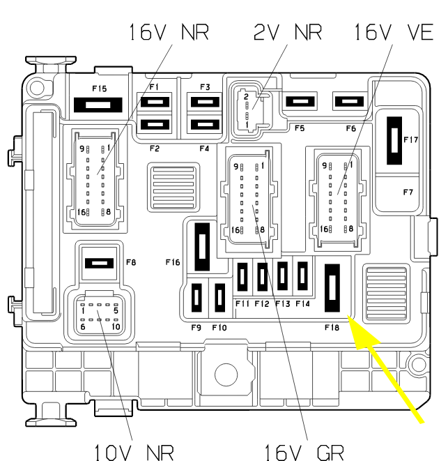

So you have the automatic Air Conditioning System with Climate Control. The Blower unit should be controlled by Fuse number F18 arrowed in yellow on the diagram. It is located on the Engine Fuse Box and is a 40 Amp fuse.
You obviously have seen the videos on repairing the Blower Motor - but this should be the Fuse if you simply want to stop it.
