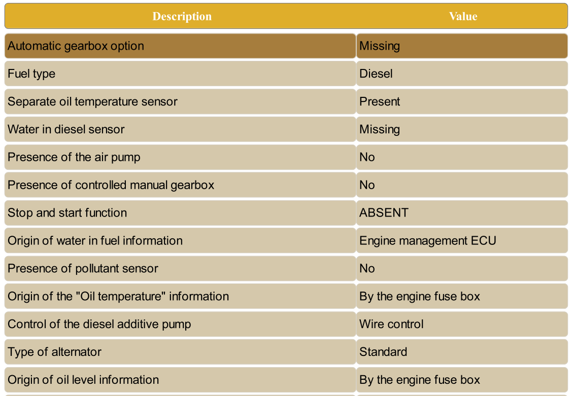

Ok, so I've been out and checked - see printout extract below. Mine is set as 'Standard'. It's a 180 Amp model but I can't tell you the brand as it is still the original without looking (and it's raining here - again

Thanks, it seems everything is ok. I have voltage oscilations in idle after turning ignition on. I seems it's time for cleaning dust from my labscope. One more time thank you very much for your assistence.
