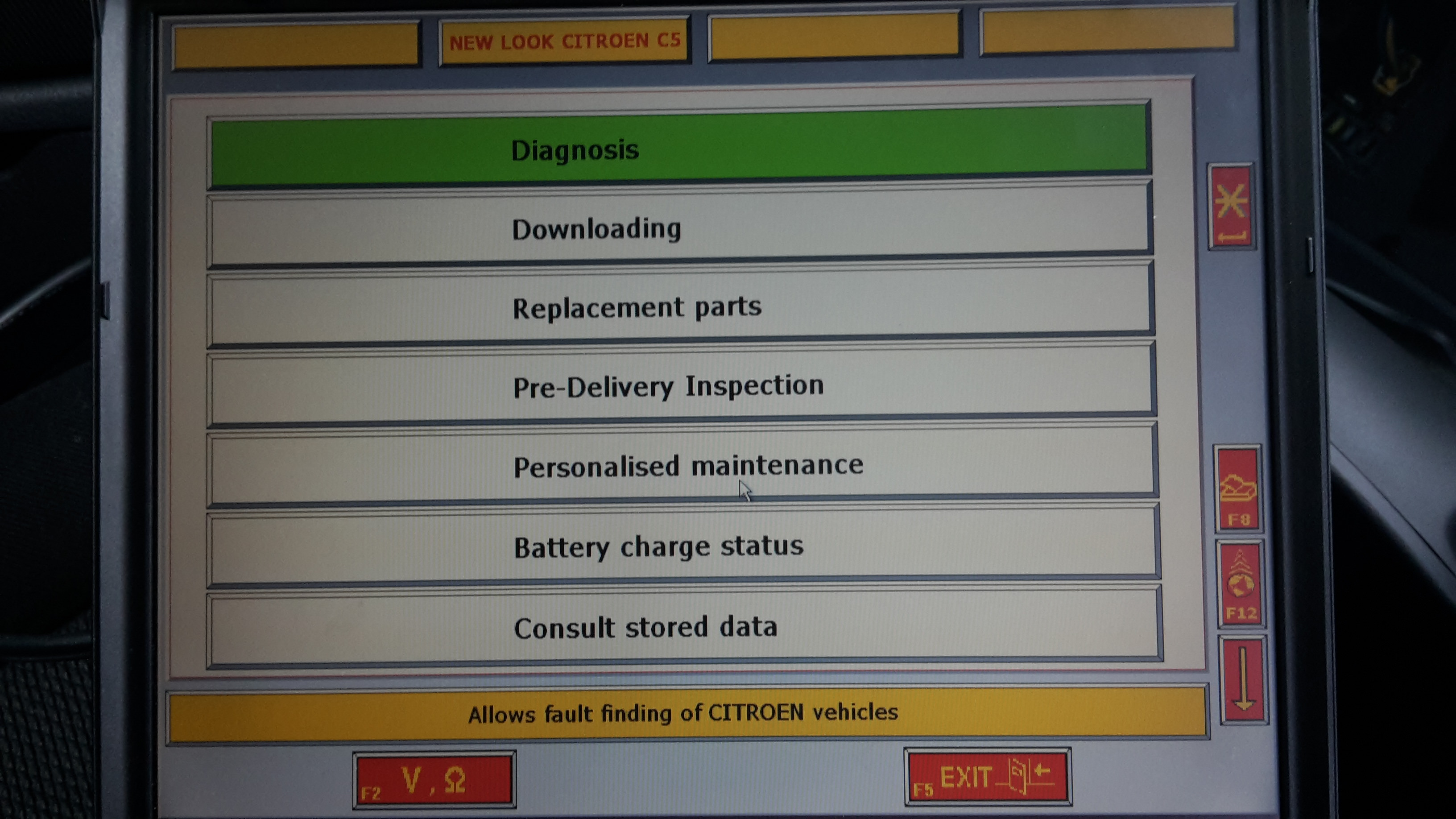

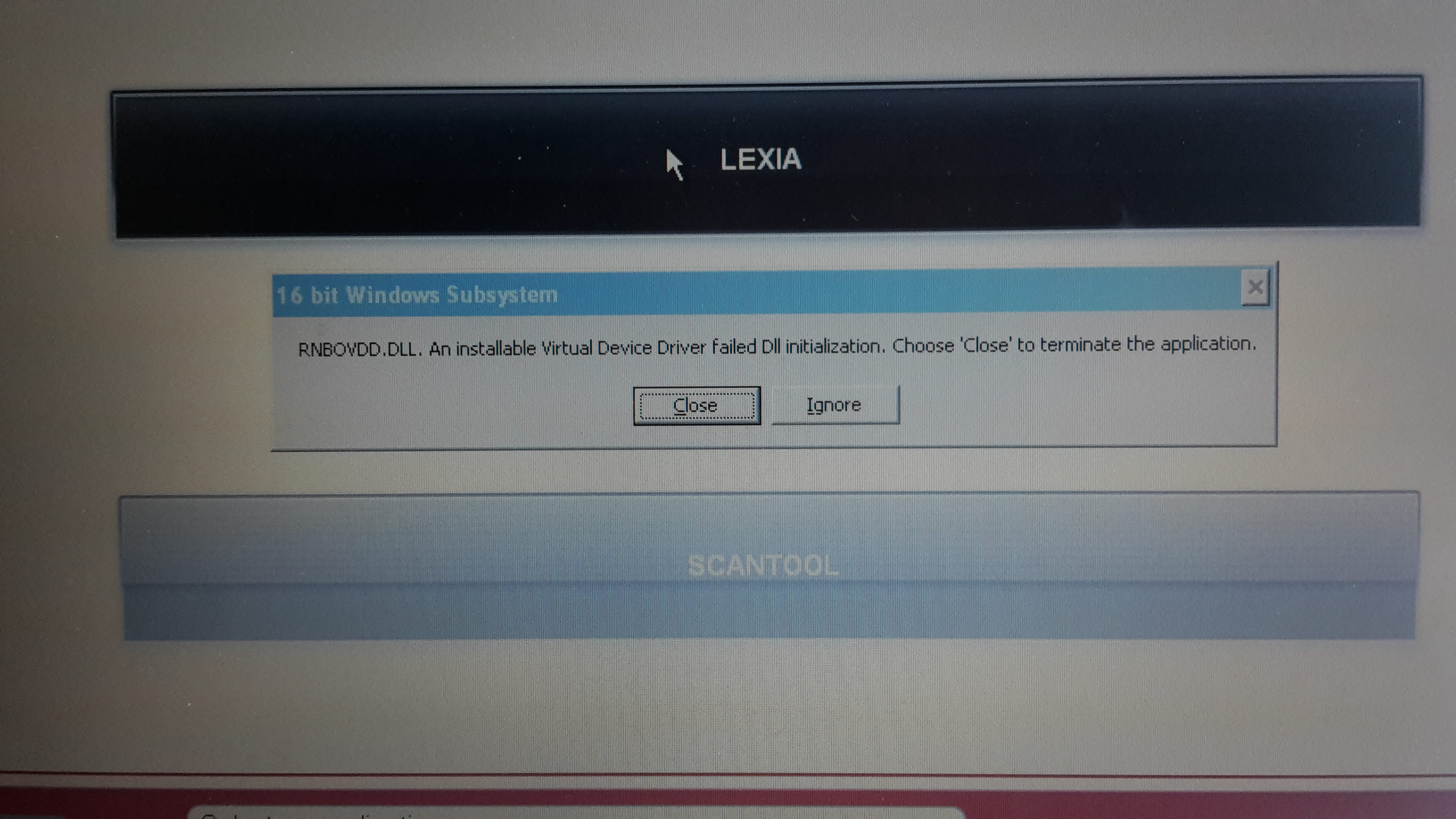

rightio, round 2!
car is an '06 not the X7
start Diagbox
enter VIN manually under C5 R, won't detect auto
get to Lexia/Scantool > select lexia and get this..
click 'ignore' then wait a short moment then i think it was RPO?
enter RPO then to Global Test? enter to this..
or maybe Global Test after?
next step gets to this..
whichever you choose...
then after stepping back...
pics 2 and 3 'may' be the wrong way round?
RPO number...i've entered 2 different ones with same result, have i entered wrong ones?
if so, can i get the correct one? i know about the A pillar sticker, just unsure which is correct?

Ok, what version of windows are you running? Is it a 32 or 64 bit operating system? That error concerns a 16 bit Virtual Device Driver - if you are running a 64 bit Operating System you can't use the Encapsulated Lexia or PP2000 programmes within Diagbox - Windows 64 bit operating systems don't run 16 bit code.

Ok, so what might be happening with this new info is that you have a newer Diagbox software version installed on the laptop, but you are using the older VCI if I understand you correctly.
So what may be happening is that the VCI has the older firmware installed from an earlier version of the software. Normally, the VCI is updated automatically to the correct firmware as you apply Diagbox version upgrades. As this is a different VCI, it may not have been updated with the newer firmware needed.
So I would suggest applying an update to V7.58 which will update the VCI firmware automatically.
If you need the update, let me know.
