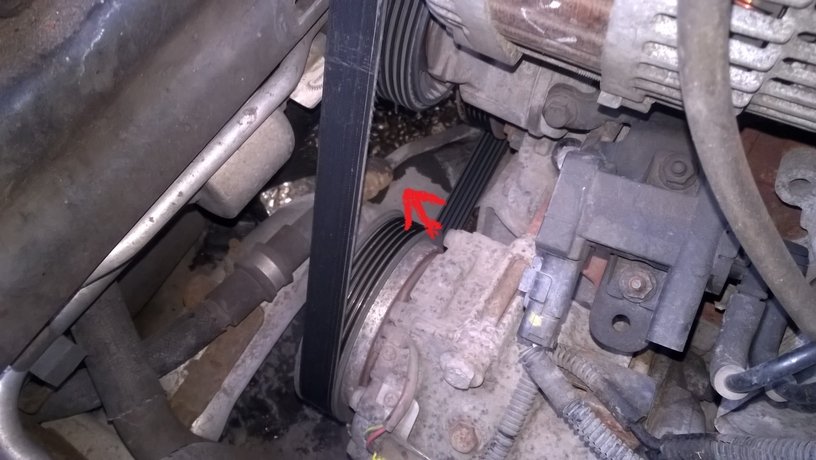

My diagnostic skills have reached a new level of incompetence! :rofl2: My 'water leak' would appear to be an oil leak! Parked up today, at mum's again, road wet through....as I pulled off, I could see the pretty rainbow-effect wet patch under the front offside corner. Bugger. Had a look, it seems to be this pipe -
Power steering? Has anyone got a diagram or part number for it please? :oops:

Pete, are you absolutely sure it is this pipe and not the dreaded steering rack leak? I’ll get you the parts diagram in a second.

You've got me wondering! :( Would the fluid drip from the front(ish) under the car, I thought if the rack was leaking it would be further back. :? That pipe is directly over where the fluid was hitting the floor.

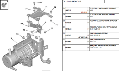

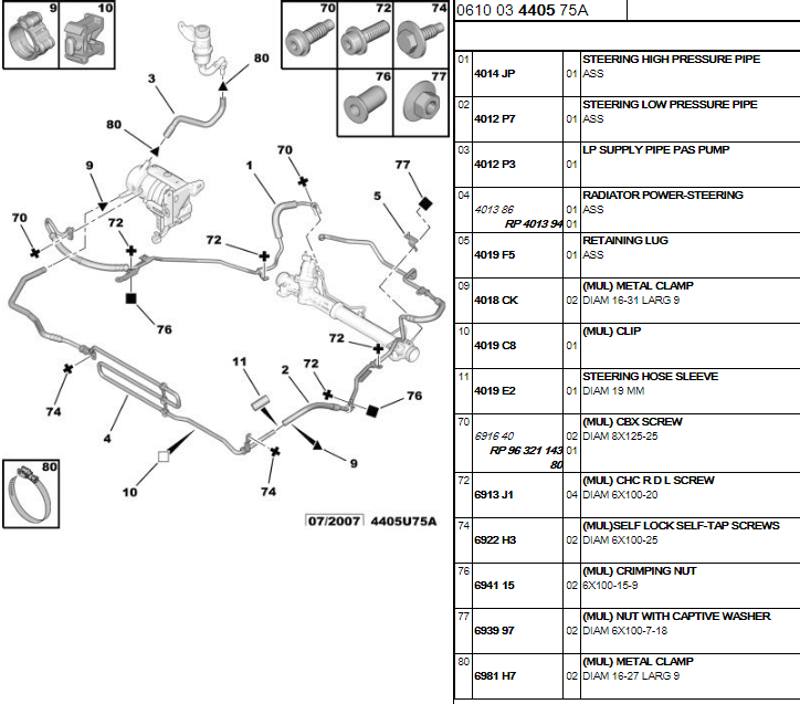

Here's the piping digram Pete and the second picture of the pump for clarity of the connections.
Click to zoom pictures
If it is the dreaded pinion leak, then will be about where the driver pedals are located positionally, as the pinion on the RHD is just below these - a good clean up of the area should determine this - but if the oil is on top or around that pipe, it's more likely to be the pipe as the oil from the steering rack shouldn't be able to get above and would drip to the ground.

Thanks Marc. My mate's putting it on his ramp tomorrow for a better look, I'll report back! If I'm looking at the diagram right, it looks as if its item no. 1, 4014JP that might be leaking....bet that'll be cheap! :shock:

£192.84 VAT inclusive Pete, if it is part 1 :shock:
