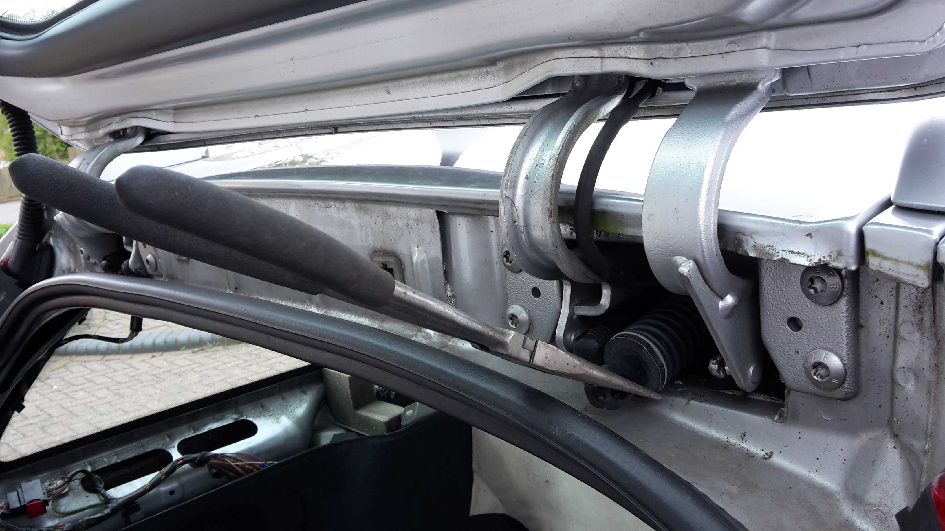

2 new struts on today....not too bad a job.
2 corner trims off, 2 cargo net brackets gently fold back lining to back of seats.
i was surprised at the access to the circlips...easy enough to get circlip pliers in or as mentioned a flat screwdriver
pop the circlips off at the front, spring back the flat clip at the hinge and pull out.
push the new one in to roughly the right length and then...
long pliers make it so much easier to ease in, pop the clip back on then fit the hinge end, repeat on the other side.
Re: C5 Estate tailgate dropping down
That inner bit looks different to mine old-uns, I'm sure the depth from the outer metal was far deeper and awkward to see i.e. you would need longer pliers to reach in to the circlips.
i used a 45deg attachment to mine and reversible so squeeze to open but i still think you could get straight ones in?
to be honest i'm not sure why the clip is needed? it's under sufficient pressure even when open and closed is full pressure and i possibly would consider not refitting but i do have time so no issue.
