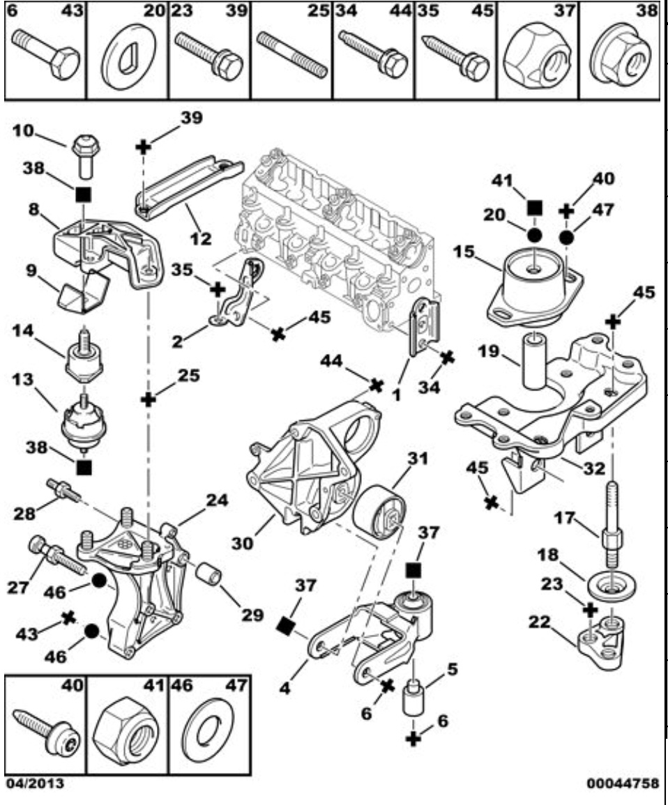

Could anyone with service Citroen look up a part number for me, the centre engine mounting on a 1.9td please.

Re: Worn engine mount
I’m assuming this is for a Xantia MK I.
Which number?
Which number?
It's a series 2, I think it's part31 that's worn.
Part number 180921 for item 31, Manual or Auto, 1.9 TD S2 £32.66 from Citroen inclusive.

Clonks on/off the power is probably the bottom mount - they get oil soaked if there is a HG weep, and then go soft. Not as easy to change as you might hope, the bush really needs to be pressed in / out of the housing - but you need to remove the OS drive shaft to get the mount off the car. I've heard some folk do it by cutting the rubber out, and then cutting the metal ring to free the bush - but you've still got to get the new one in!
- x 1751
Drill and cut the old bush centre tube out, and hacksaw through the remains of the rubber and outer steel tube. It should then collapse and come out easily.
Press the new bush in dead-square with a vise, and a large socket to press on the outer bush edge. A very gentle bit of chamfering of the leading edge will help, together with a smear of oil.

Hmmm I think that’s not a job for me in my current medical condition. Lying under a car removing driveshafts and bushes is not really doable in my current physical condition, and highly unlikely to be for some time if ever, hence the reason I bought a 31000 mile 107! Therefore that will be a job for someone else. It’s definitely the bottom mount, I did have a quick peek. And the gear-lever moves when coming on and off the power! It possibly was caused by the leaky fuel period which has miraculously cured itself. Had a poke about with a vanity mirror taped on to a ruler and can’t see a leak anywhere, so I’m not touching anything to do with that either!
