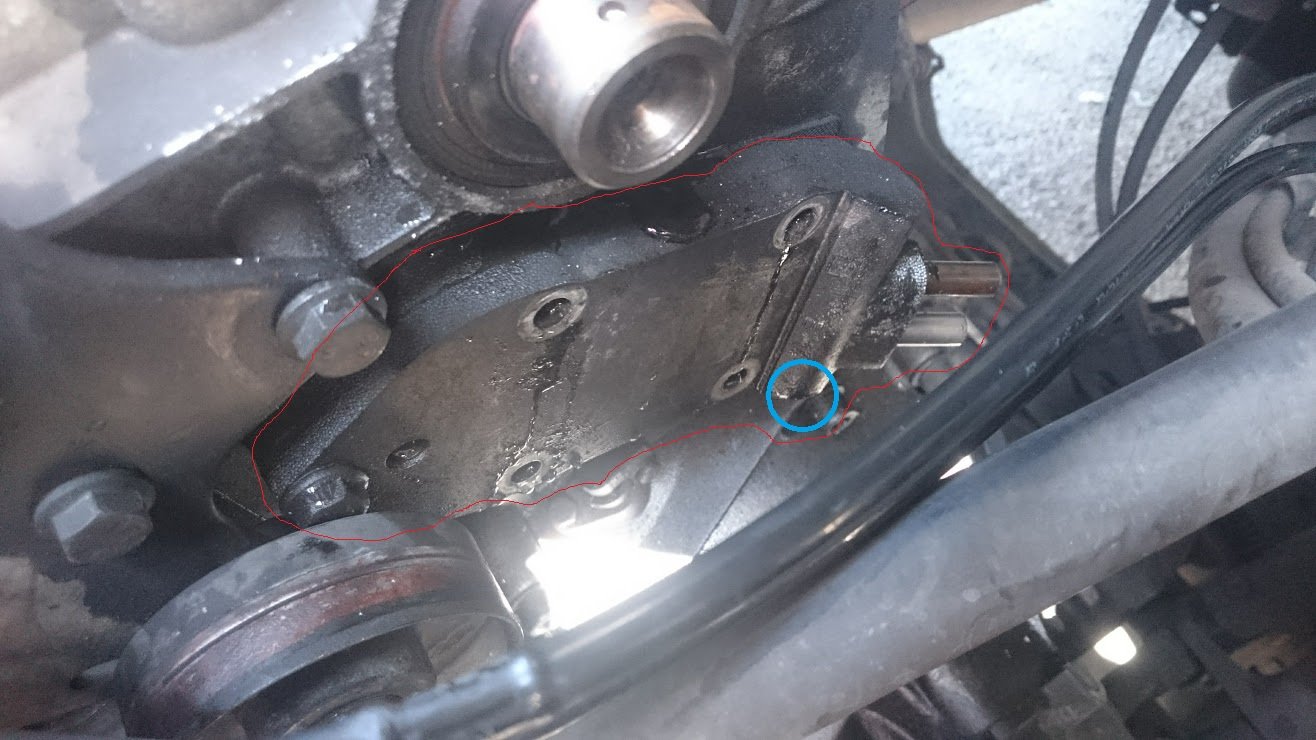

Hi, I've just come across this site while searching for a clue. Could anyone help me please identifying a part that leaks the fuel? I attached a picture. The blue circle shows the place of the leakage and the red is the part I am curious about. Thank you very much!

That part is the diesel fuel preheater. Fuel passes through a cast labyrinth inside it, and is heated by the part being in contact with engine coolant.
The part has been known to go porous after many years of duty, and can leak, sometimes from the tubes and a blanking stopper which connect it. The unit usually fails by allowing air to be sucked in (the fuel line is under suction), which can cause difficulty starting (air in fuel). With the engine is switched off, the suction (from the injector pump) stops, and fuel can weep out.
Unless in extremely cold climate, the unit can simply be bypassed (the two fuel pipes joined together), leaving the unit in place, but out of circuit.

Hi Chris, thank you for your reply! I hope we can sort it out now... It started leaking when the temperature raised in the last few weeks.

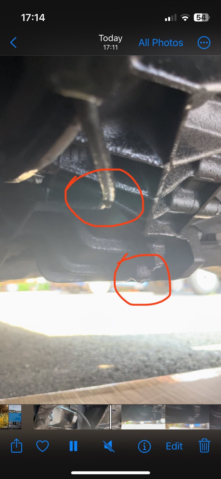

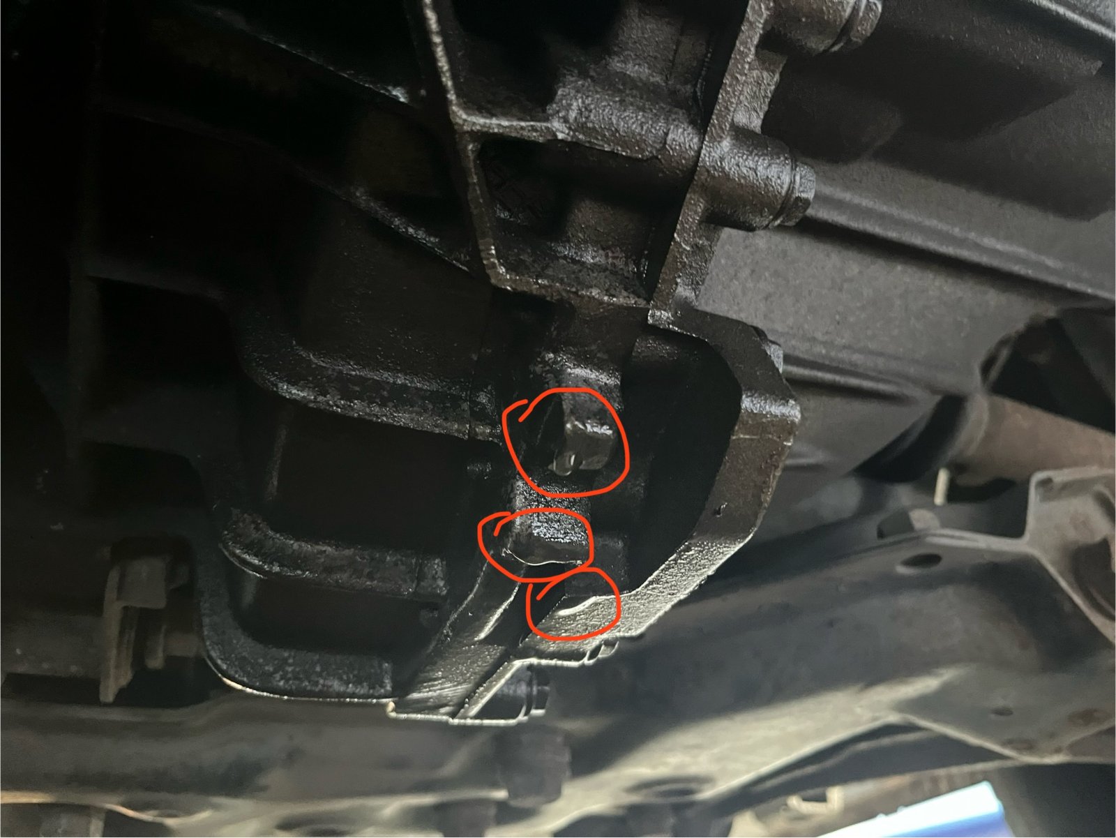

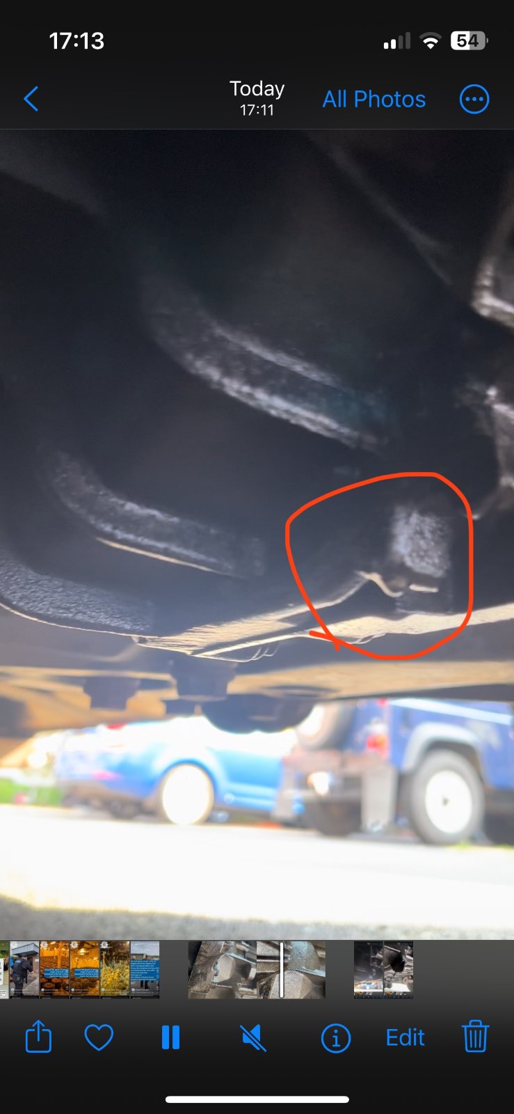

Could this issue also cause a slight loss of power? I'm down about 10% on power over the hill I commute over each morning. What was an easy hill at 40mph, is now a struggling at 35mph. There's fuel dripping very slowly from somewhere I can't quite see but it's finding it's way to the very bottom of the gearbox casing.
