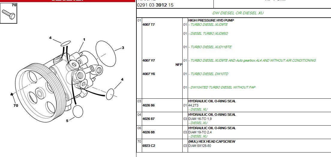

Hi all does anyone know if i can get a washer kit for my car's power steering pump I have a small leak and nothing is available from Citroen in France except a complete new pump at over 1000 euros, not even worth thinking about, or where I might get a recon one, any advice would be welcome as the car is off the road thanks to Citroen for sticking the pump above the alternator,Cheers Bill

Where is it leaking from? Some seals are available - if this does not cover your leak, try contacting Plaeides in Sawtry as they re-build the pumps.

Many thanks Richard there is a 19mm plug to the rear of the pump with a 12mm plug screwing into it and that has pipe attached to it that goes down to the front passenger side sphere, the base of the 19mm plug is where the leak is, I have found out that there is a washer similar to a tap washer on the bottom of the 19mm plug, I hope this means something to you

If you have not worked it out already =, you need 19mm o-rings with 2.4 or 2.5mm round section. I prefer to use 2.5 section Viton o-rings, purchaed on ebay, as I think the originals are a bit mean in temperature rating, and do always fail.

Thanks xantia v6 I obtained an O ring kit from Plaeides so hopefully they should be correct for the job, your tip about the bleed bolt is very useful many thanks.
