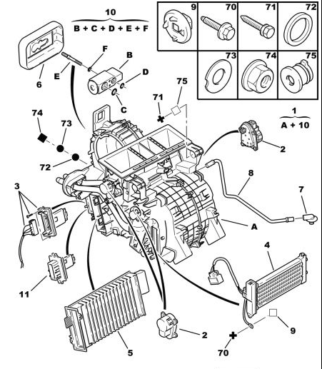

Ok, so you have the automatic air conditioning system. Looking at the diagram below you can see the gear reduction motors referenced as part number 2. There are 3 of these, which operate collectively to ensure the right temperature is maintained throughout the vehicle.
| (2) x 3 - A/C Reduction Control Motors (5) Pollen Filter |
