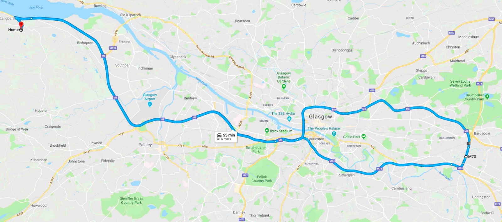

Right, I'm going to take it for a run, I've mapped a route which is all motorway with a minimum speed of 50mph, maximum 70mph that I don't actually need to come off the motorway for at all so that should give it the perfect chance to do a regeneration.
Will Lexia it when I get home and see what it's showing then!
Fingers crossed.
David.

Good luck with that David, with all the excitement, don’t forget to turn round and come back!

Right, I've done 58 miles in it, 55 of which were very sedate, the last 3 I gave it a bit of abuse on the way home.
Differential pressure at idle is now showing 13mbar, at 3095 revs it's showing at 104mbar, so if anything, the pressures are higher then they were before. Those readings were straight after a drive.
Interestingly, I've not had a single warning from the car that there is a risk of the DPF clogging this evening.
My distance travelled since last regeneration is currently showing as 94km, the average distance for the last 5 regenerations is 509km. I'm not surprised the average over the last 5 is down as I've not used the car an awful lot.
David.
