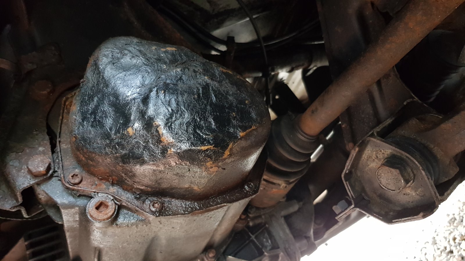

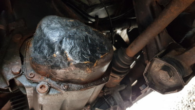

The gearbox on my boxer motorhome is leaking from the end cap, it has been bodged with some unidentified hard gunk but I'd quite like to get a new end cap. Does anyone know what gearbox and oil goes in a '97 5 speed 1.9td boxer van and where I might find a new end cap? There was one on ebay a while back but the bolt pattern looked a bit different to mine...
Here's a pic.
Here's a pic.

The two likely options are the BE3 gearbox and the ML5T gearbox (or derivatives of).

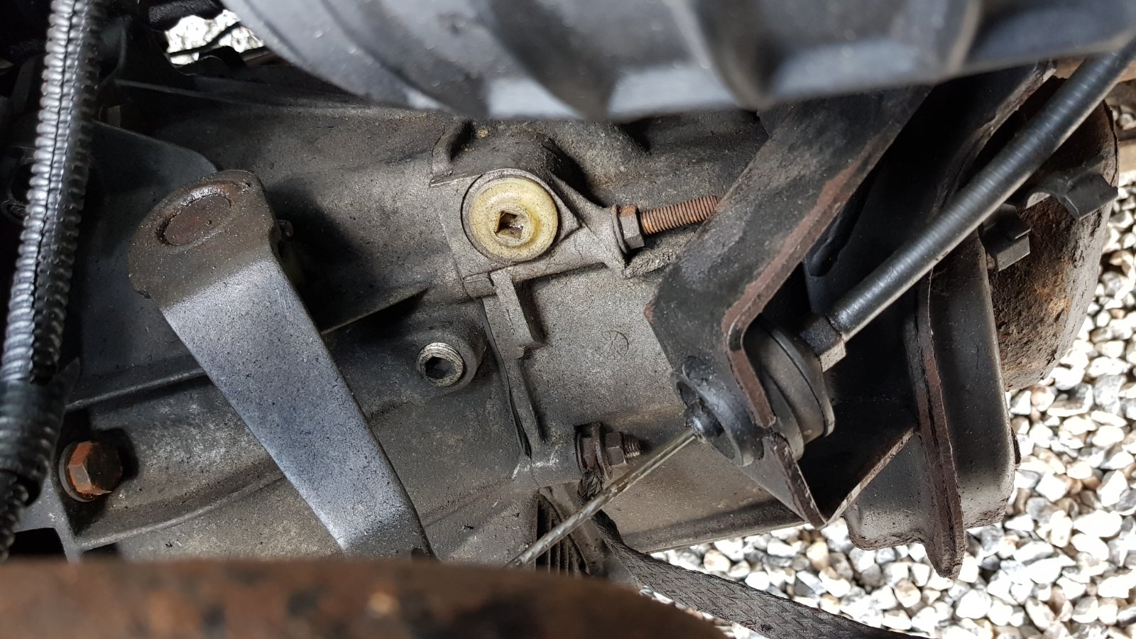

Yeah, I had thought it was an ML5T, it has a cable operated clutch though. As a temporary measure was thinking of replacing/topping up the oil, is that the level/filler plug on the lower left hand side?

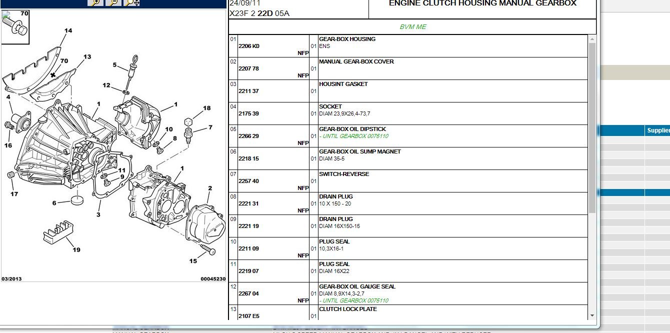

That doesn't look like a BE3 or an ML5 to me... I think it's an ME box. As said, post up the VIN and we can have a look.
Depending on the age of the box it might have a dipstick on the OS of the diff! I can't see that plug in the parts diagram, it does look like the drain plug. All PSA boxes use 75W/80 oil. Not sure on the capacity for an ME box.
The end cover is part no 220778 - not available anymore. Only used on Boxer, 605, Relay and XM.... If you could scrape the carp off, you might be able to get it welded up?

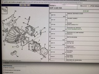

Re: '97 boxer leaking gearbox end cap.
That's it... although even Citroen doesn't know which box is fitted
However, the mount just up and left of the end casing is not on the ML5 box, so it must be ME. It says 1.85l of 75W80. That bolt at the bottom left of the end cover doesn't get a mention anywhere; I wouldn't remove it in case.... There should be 2 drain plugs - one on the diff, and one on the bottom of the main casing just next to the join.

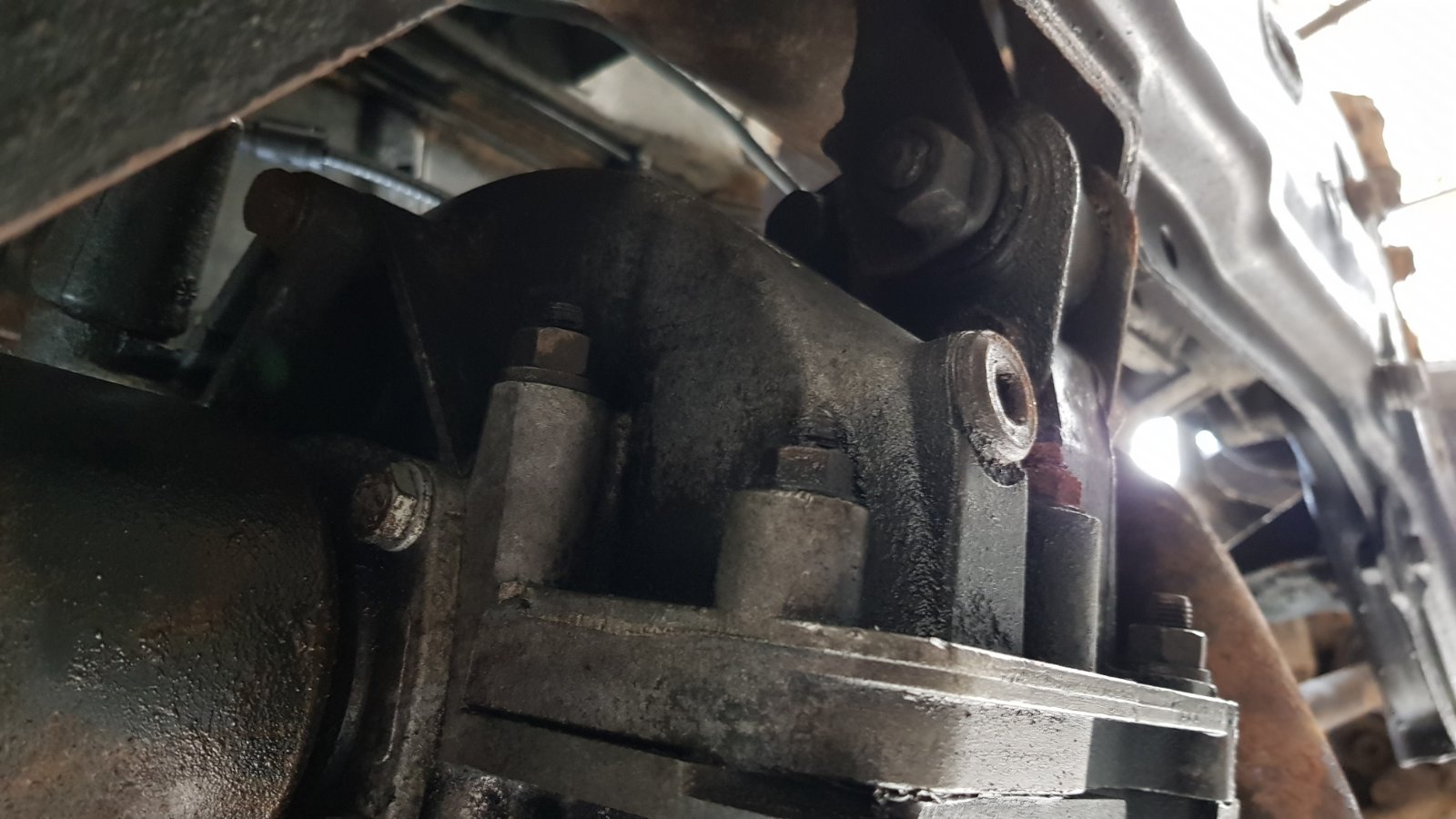

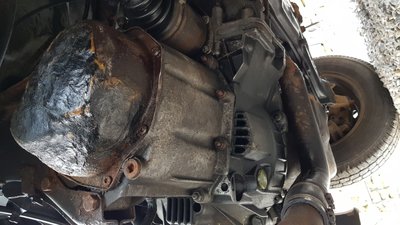

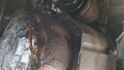

I've taken some more pics, what would really help would be models of potential donor vehicles since that part isn't available new anyway, does anyone have those?
Is the plastic plug the fill point?
Have a word with Dean Hunter, http://www.peugeotparts.co.uk/ I`m sure he will have a second hand one,he may even have a new one.
Failing that it looks like a steel cover so should be possible to weld it up, it certainly looks battered.
Peter.N. wrote: 11 Apr 2018, 10:55 Failing that it looks like a steel cover so should be possible to weld it up, it certainly looks battered.
It's very thin metal as well,it's just a tin cap held on with a few screws. Easily removed,I bet when it's all cleaned up you will find its rusted and perforated.
If you do find a good second hand one(or a new ?) give the outside a good clean and lots of coates of hamerite.

I just checked, has to be my cover - you were right first time Richard.
I'll ask Paul. There's an XM on ebay over in Newcastle but has a 2.1 and already is a few hundred quid.
The problem I have is getting the cover off without knacking those torx bolts and when I do keeping the gearbox dry - the motorhome is nearly ten foot high. There's a garage just down my road I will ask them to remove it/ weld it and keep the vehicle under cover because I have a feeling it will fall to bits at the first sign of a spanner!
