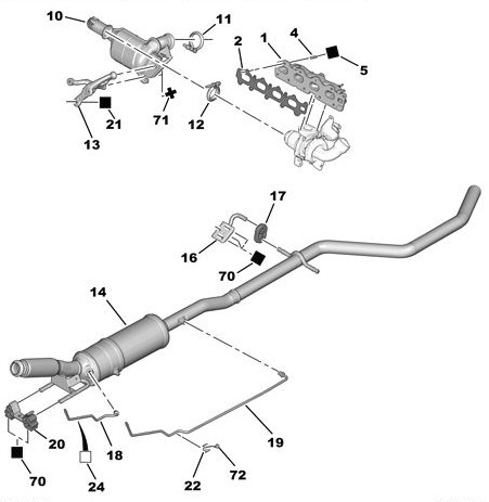

hi all, I just popped under mine (on ramps) to see what a DPF looks like..
all I saw was a long canister, bolted up near the manifold, and then joining the main exhaust pipe all the way back.. is this it? it has one sensor, and there is another sensor in the exhaust further back?

Yes, you have identified the DPF but the good news is you can cut the pipe at a mark on the exhaust and clean out DPF with a caustic soda solution probably 1 % and buy the pipe from Mr Auto's for £25.

Here's the part laid out:
Parts 18 & 19 are the differential pressure pipes
Part 14 contains both the Catalytic Converter in the first part and the Particulate filter in the second part of the cannister - so be very careful. Have you considered Halfords? They offer a DPF cleaning service:
https://www.halfordsautocentres.com/car ... deep-clean
As for the rack - when is the MOT?? It won't pass with that leak as you know, so if you can get the DPF cleaned , you can divert resources into the rack if you are going to keep it - but I suspect the rack will have to be the priority as that will start to eat through LDS as it gets worse.
