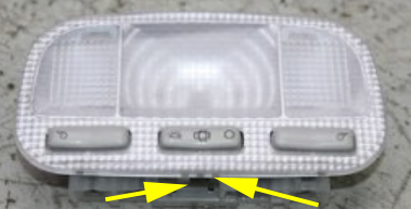

Hi guys does anbody have a procedure how to change bulbs over drivers head. I have try to take off the plastick but i am afraid to brak it.thx
x 6950
Re: Citroen C5 X7 front reading light

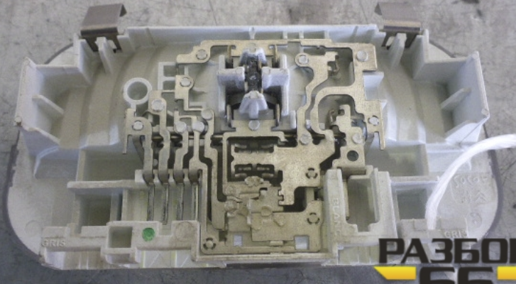

Just use a small flat blade screwdriver to carefully prise the clear plastic cover off at the front as arrowed. The second picture will give you a better idea of what is inside so you can see. It can be tricky, but a little bit of gentle force is need to prise it off.
