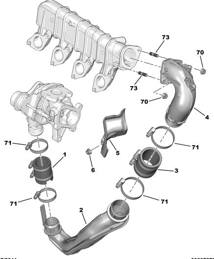

Here's the Turbo air piping for you to identify and check:

Thanks, I'll follow those pipes. Any idea how it's actuated or the boost measured?

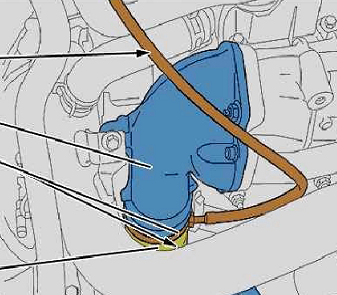

They list running a pressure check using a gauge attached here:
