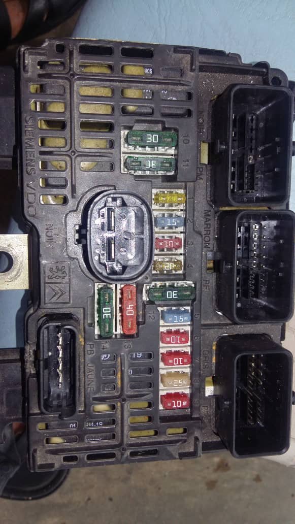

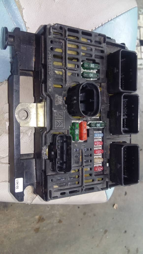

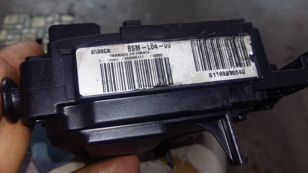

Re: Front wiper working automatically
After all advices..... We found the problem, It's the BSM unit which is faulty.
I have attached the BSM L04
If any one can help to get this BSM unit
Will be great..... I was unable to fine it in eday
Thanks
Thanks

Put this into Google: 6500 CK is the part - plenty coming up, but not cheap.
Citroen 6500CK
Citroen 6500CK
I'd be interested in what the actual fault is on that, is it something that can be seen?
